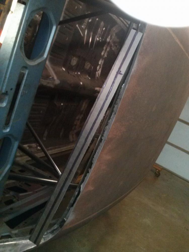

And thanks for all the compliments guys, as I've said before I would never have thought about doing this project without this forum. Many thanks to all. The window is going pretty good, just taking one section at a time. A lot of the metal I have used was new metal cut from the wheel-house mod leftovers, some pieces were already angled to fit. I just put the curve in them with the shrinker.

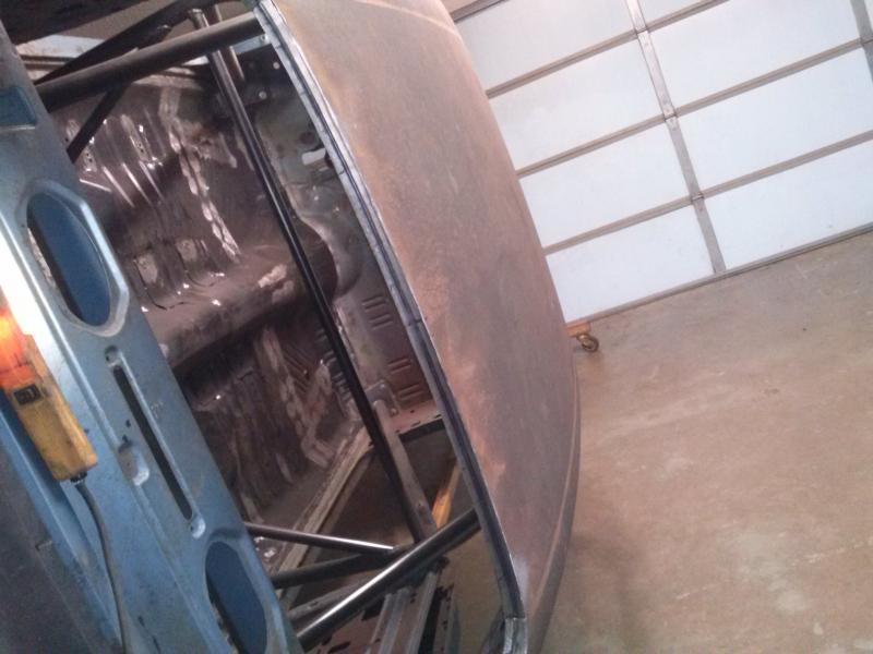

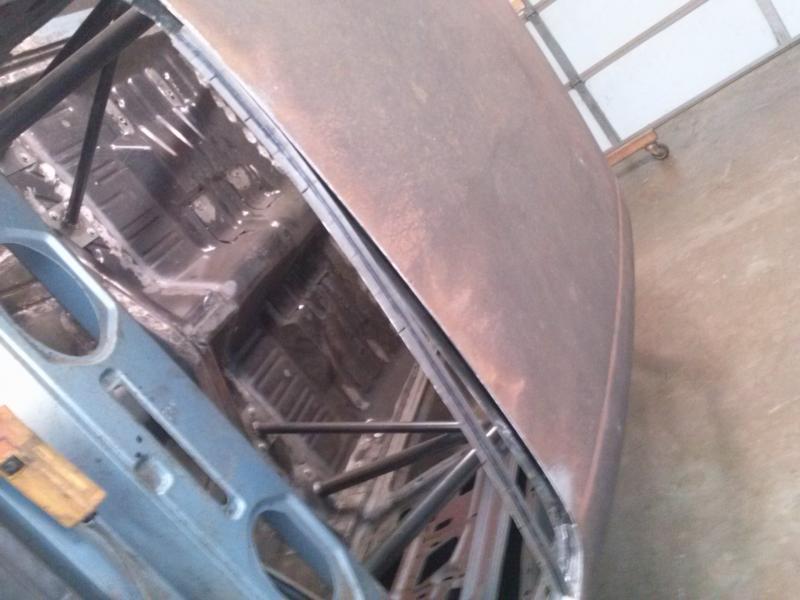

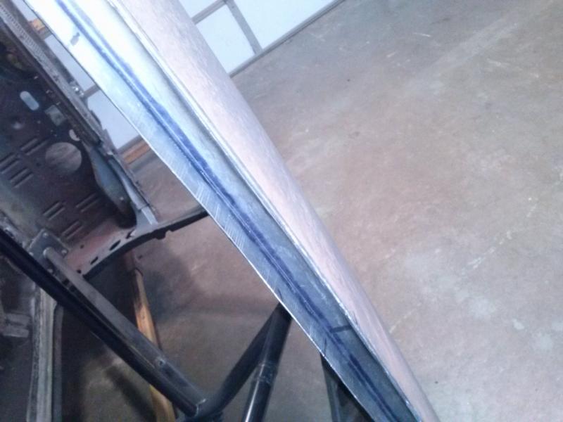

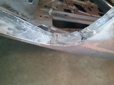

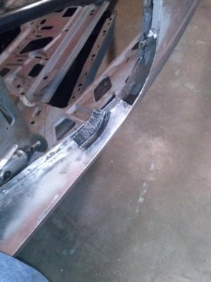

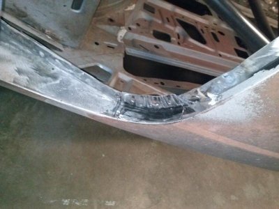

This is the last corner, upper right outer. I'll save the grinding for tommorow. The top piece will join here and the other side. Hope to get the top piece on by the weekend or ready to go on. It will all be done after that one.

I imagine everyone here has seen that clip or the whole movie before but its a good one, Myself i would rather have the Charger then the Challenger, thats just me but I like the Charger much better! and your right, its a shame when they tear up good cars to make a movie, or a show, especially Mopars, at the least our b-body cars. Your fabricating looks real good!
Looking good daytona! You'll be on cloud 9 with that whole window shelf done, I know I was at least haha keep on keepin on!
Fer Sher, It has been a pain.

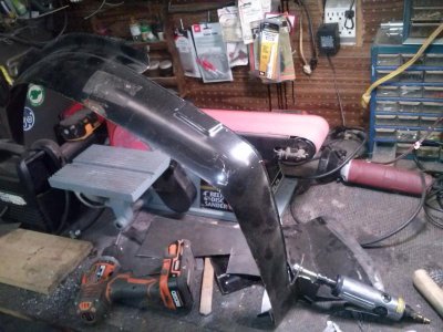

The trick for me was getting the welder set right, (way low) once I got that it was like "micro-welding made easy". About a 1" weld then let it cool, I use a wet rag to cool it.
A bunch of different grinding tools and attachments have been used a lot, even my little dremel tool.

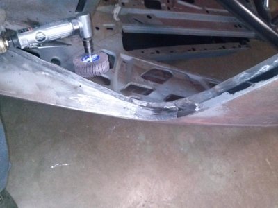

Here is that last corner after cleaning up.

Yep that's the way to do it! It's a pain in the *** keeping it cool along the roofline to keep the roof skin from warping, too but looks like you got it well under control. Looks like you're getting your money's worth out of that shrinking/ stretching tool, too :icon_thumleft:
