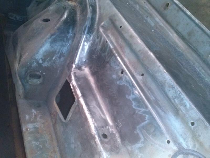

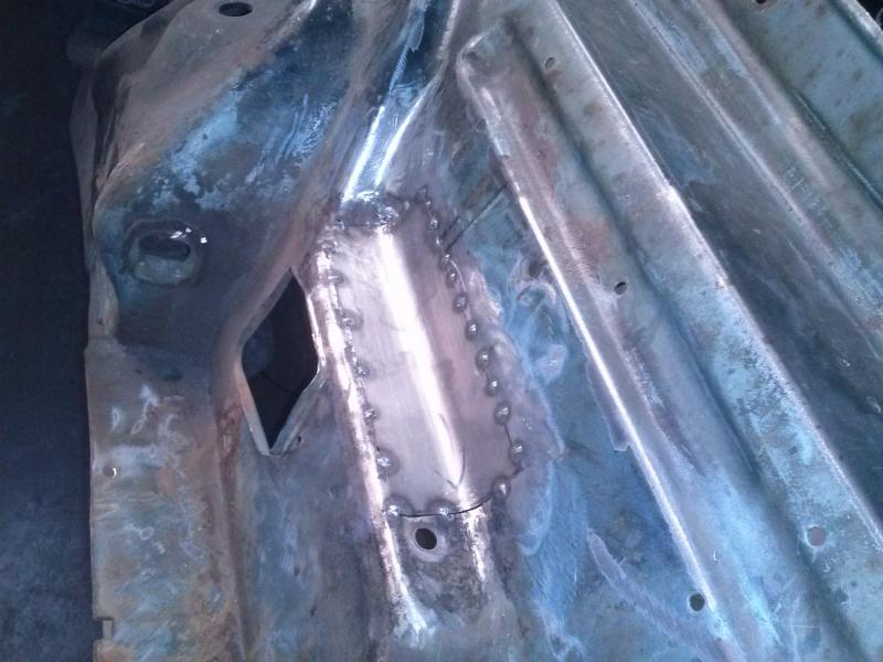

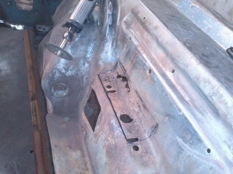

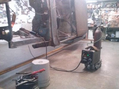

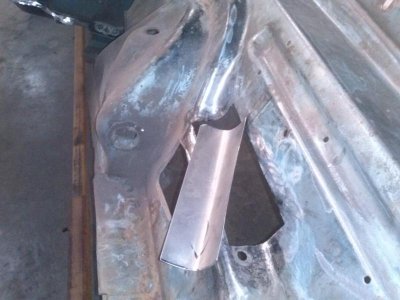

Here is probably the last rust patch repair on the unibody, unless I find/remember anymore spots. This is where the battery ate at it. I made a stencil of the holes, may not drill them, yet., since I plan on a trunk batt set up for now.

I agree, Outstanding work, you can really see the difference in your welding from start to all this, great results for sure and a pleasure to watch.... and learn.!! Envy bug-ah- biting seeing it on that rotisserie :)
Yea, I wish my welding had been better at the start. I went back, ground off and re-welded a few spots that will show more on some of my crapy ealier welds.
Don't you just hate that, as your skills advance you become more and more picky about everything. For me it's a huge problem "my skills don't seem to keep up with my expectations, haha". Keep up the great work
I don't think your giving yourself enough credit, You have done a top notch job all thru this and just think, The next car you do, if you get another will be top notch and you'll know exactly how your going to do it!
Im not trying to be a smart azz with getting another car just sayin i think i would want to after the learning curve you've had, heck even when you weren't using the gas the welds looked good and the metal work around the window and other places speaks for itself not to mention the roll bars!

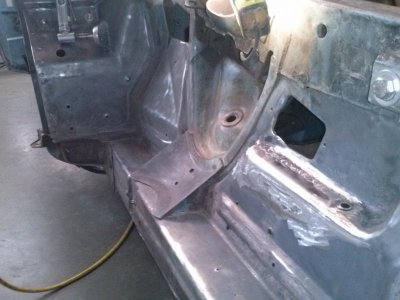

I've been cleaning/burning and scraping off undercoat and getting a lot off surface rust off with a wire brush in my air angle grinder. I figure the more I can easily clean now will be less blasting. Amazing how new some of the areas look after removing the undercoat.

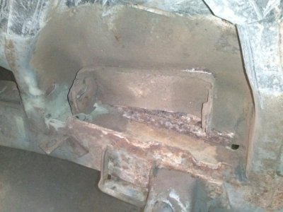

I keep finding/remembering things to fix before major blasting. I guess I will start on repairing this rusty area around the upper A mounts. This is the worst side. I will order some new mount brackets and I think I can repair the rest. I will blast this area during this repair to get out as much rust as possible.
