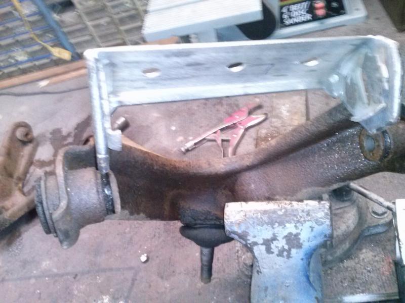

And what's worse is you pay $180 for something that doesn't even fit. Guess I should have made them myself. And even worse I didn't think to check this fit before I welded the cam washer holders on, so I can't send them back and if I could I would probably ruin the holders removing them again. I plan on sending "SafeTcrap" and Auto Body Specialties an Email with this pic and ask just exactly how someone is suppose to make these work. I think I can make them work but I'll have to cut them in half, cut off the difference and weld them back together. :angryfire:

Wow sucks to hear about those control arm mounts, at least you'll be able to make them work but that's bs

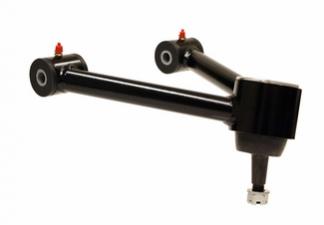

Just ordered a set of tube A frames to help me solve the bracket problem. $290 total from Mancini, with 10% discount for Black Friday.. Didn't feel like fighting with the old ones and these are ready to bolt in.

Those would have been hard for me to make also, Probably 6-8 hours of work. I look at stuff like that and think if it takes me longer to make it than if I worked the same amount of time at my job and make more than they cost I should just buy them, but I would have made them to fit. Auto Body sells them separately for $75, but they get them from SafeTcap, who sells them separate for $75 and as a set for $130. Auto Body rips you off by not offering the set and SafeTcap makes stuff that doesn't fit. So I got ripped off twice in one purchase.

Man that sucks bout the control arm hangers. I've yet to hear anything good about SafeTcap products. I would be pi$$ed. Seems like their stuff is made for the people who cobble things together and don't care what the structure is like. I saw ads for their frame rail and trans crossmember caps. They showed just covering up the old rusted metal with their products. Why would anyone leave rotted metal in a car they are restoring?
Yep, I bought some of those rear frame rail caps and was going to use them till I found the partials that I spliced in. Fortunately I was able to send the caps back. I didn't realize ABS was going to drop ship the control arm hangers from SafeTcap or I would have looked for better ones elsewhere.

Work is looking good Daytona Kid! I haven't had any good dealings with AutoRustTechnicians Safety-Cap either and sorry to see you're in the same boat. I've installed two sets of their torsion bar crossmember "caps". Hours were spent modifying them to work and the last set installed I really lost my *** on the deal. ABS (Auto Body Specialties) don't stamp/fabricate a thing. Had a few dealings with them as well, not so good. No one likes redundant work on new parts, just pisses a guy off. As you and other folks know here, it's part of the game. Guess all we can do is just alert each other on which ones are the worst. Best of luck.

I should be getting my new A frames tomorrow to help me resolve this bracket issue. I think that maybe my old A frame bushings had swelled and that is what caused the not fitting problem. We shall see when I get the new A frames.

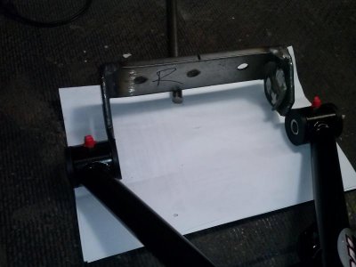

I got my new QA1 A frames and they look great.. And with them I confirmed my suspicions. The verdict is in on the ABS/AutoRustTechnicians/SafeTcap A frame mount brackets, GUILTY AS CHARGED! They are definitely made too wide, by 1/4". I just don't understand how a company can make crap like this. Surely I am not the first person to have a problem with these. I am going to Email them and rip them a new one. I don't think anyone else makes these so I will cut them in half, remove what I need and weld them back together.

Its good that you have it figured out anyway, Your new QA1 A frames really do look good! I hope maybe others who are reading this thread go the same route as you ripping them a new one, maybe they will get there act together making these, making your own stuff is fun but its time consuming and you/we don't need that when were trying to get things done. I bought a new media blaster from Eastwood and the tech had me tearing the whole thing apart trying to figure why it wouldn't work right, they sent me real course media that there nozzles wasn't large enough and although i hate to admit it, it was partially operator error! I didn't have my air valve and media valve adjusted right working on what he told me to do, i would think he would mention making sure things are on and flowing right, Once they sent me the right media, ill just say i love that thing for blasting and quickly. Good luck here getting it together!!
