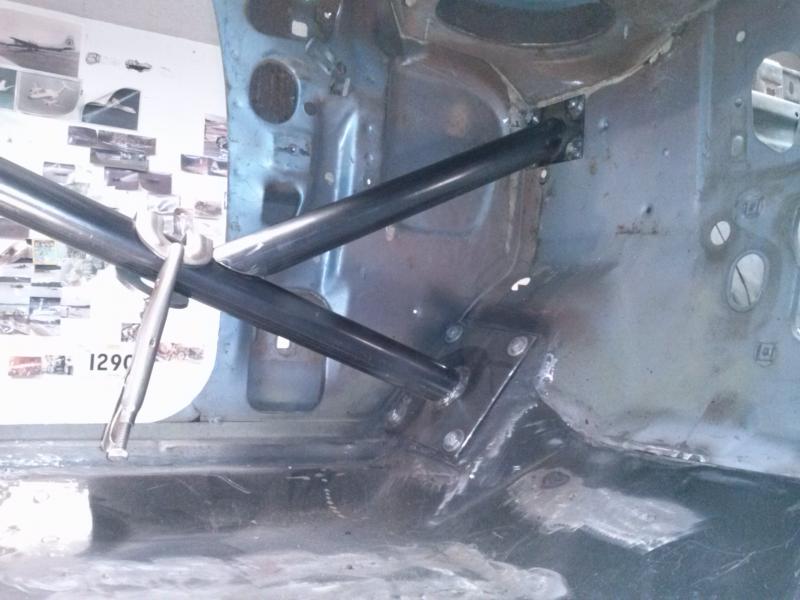

Don't get me wrong, I think that just the tubes as seen in my pics add some stiffness , but a lot more will come with the additional tubes I'm putting inside the cab..,, It's the extra plates that came with them that I don't think are not much extra strength.
Are the plates for the upper shock tower or to mount the tubes? I was talking about the ones for the shock tower
I'll give these a thumbs up for ease of install.. They came with some extra plates/pieces that would beef up where they meet the shock tower but I really don't see them adding that much strength, so they're probably not going on unless someone can convince me otherwise.
Thanks for the review Daytona Kid . . . like Tallhair, I've seen a couple of different styles of tubular supports ( like yours ) that I've been thinking about adding to my convertible for some additional strength too . . . but I'm wondering how much added rigidity it'll really add to the car.
Very good thread. Another reason why this site is far better than other sites because the majority of people in here are doers, not just dreamers, but, DO IT!
Yea, the ones to add to the connection at the shock tower, I can't see them adding that much more strength there. Plus they really don't want to fit there very well. There are 2 plates to put there at the front shock tower connection for each side. 1 of those plates doesn't come close to being able to fit. I'm sure XV wants you to grind them to fit better and I could have been able to make them all work but I feel it's fine like it is without them. XV has videos showing how their stuff works > http://www.xvmotorsports.com/products/detail/index.cfm?nPID=299&cid=105&cdesc=Chassis Stiffening and most of it works along with other stuff, such as the brace over the top of the motor which attaches near the top of the shock tower thus helping the inner fender tubes like I just put on. Don't think I'll put one of those on.

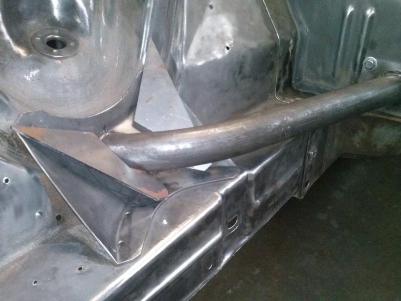

Thanks Guys!. Got the tubing to finish the connections of the stiffeners to the door bars. Ordered the extra tubing from Jegs thurs, got it sat am.. Great service from Jegs.

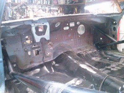

All done with these.. And one last thought about the XV stiffeners,. If you notice in previous pics, the XV inner fender stiffener tubes use the 2"x3" plates to mount to the front side of the firewall., without something like what I've done here to the back/inside, the thin firewall metal is not something that I would think would really have enough strength to make the tubes very effective. JMHO

Daytona Kid - You matched the plate on the firewall for the roll cage - to match the plate that was on the XV Frame stiffener - Sounds like a great idea !

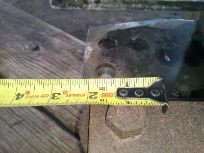

I cut my leaf spring hangers back off so I can use my rolling stands, since they bolt on where the hangers go. Member 69GTX made me aware of one difference in the offset hangers and stock ones. He's working this situation out for us, since his set-up is like much like mine. As you can see here there is .5" difference where the spring bolt goes thru. I may try the fit with tires and wheels with the extra .5 rearward, but that will be later.
