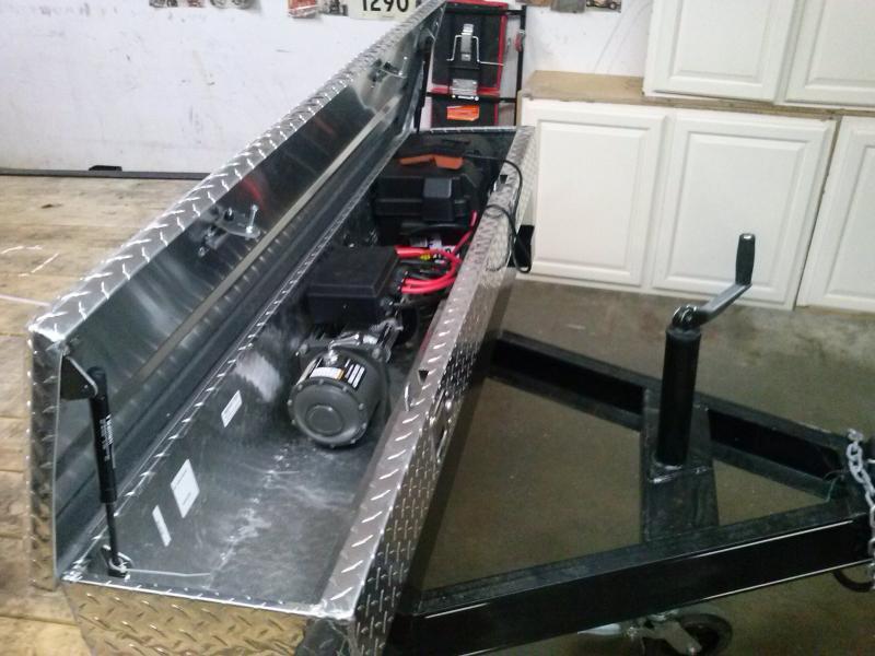

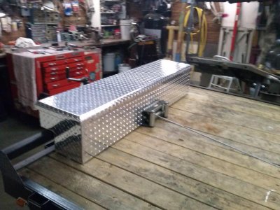

Still waiting on a good weekend to blast.. In the mean time I bought some stuff for the tow rig/trailer. A 9,000 lb winch and a tool box for it to live in. I'll add a battery for it, and some basic tools, equipment, straps, etc. Gotta cut a hole in the backside of the box for the cable and mount it to the trailer.

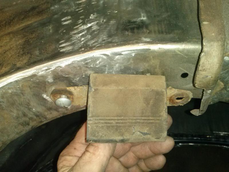

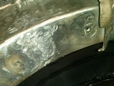

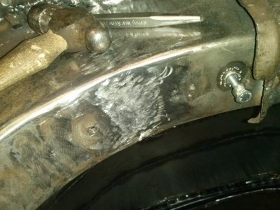

I had to weld a nut in the new rear partial rails right at the splice where the snubbers bolt on. I ground the nuts down to a smaller diameter, tapped them into a tight fitting hole I drilled, welded them, then ground them clean. Worked out well. And yes, I am going to get new snubbers.
As usual DaytonaKid . . . very nicely done - You do very nice work ! ! ! I'm sure we'll be seeing your car on the road soon, you're making great progress ! ! !
Good to hear "going to buy new rubbers" kinda gross reusing them if you ask me haha. Nice work Daytona
Your work as usual looks great! The Dodge 1/2 rails must be a little different then the Plymouth, mine just has the holes and there kind of like a screw bolt type that gos in them, same as original on the Plymouth.

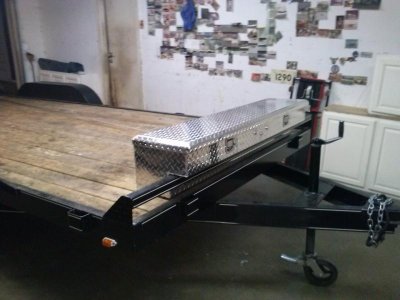

I also finished up the trailer winch box project and it worked out great. I welded a 1/4" plate to the trailer frame under the box to handle the stress on the winch.

Nice set up, That's a cool outfit!! It sounds like they would be ok with it, legally is always good but if there on the friendly side its a good thing, but seems its like the last bolt or nut you need to take off, there's always one..
