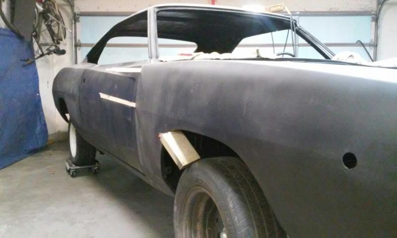

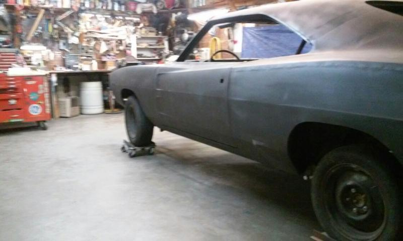

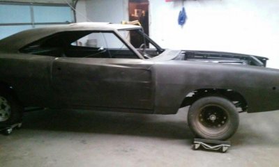

Finally the front fenders.. One down, one to go. I may have to take them back off in the future, I didn't put any of the splash shielding in. I may put some type of plastic or rubber home made splash shields in them., just thinking outloud.

Looking like a Charger again, what color are you going with or have you decided (sorry can't remember).
Black I guess,. I had thought about red but I think I've painted to many areas black (door jams, engine bay, etc.) to go red or any other color now. It may be quite a while before the final paint since I may be doing a lot of the filler, sanding, and other prep work to help keep my painting bill low. I also may get it running (moving under it's own power) prior to paint also..
But I can still dream>
I like the blower and there will be less sanding to do on the hood as well!
Cool beans!! Another mean black Charger to hit the streets. My condolences go out to you and your elbows..lol Block sanding for a black car is always a bear! Pay off in the end, having a laser straight black paint job is well worth it. As far as how to deliver the car to the painter, i'd just ask the painter. I would guess your panels will be coming off/on a couple times during body work anyways. Anyways, great to see your Dodge so close to the next big stage of paint.
Yea, it feels good to get to this point, it seems more like a car now. But like I said, It is going to be quite a while before final paint no matter what the painter says as far as running or not., unless I hit the loto! lol.. I am really thinking it would be better to have the motor and most of final weight in it because I'm pretty sure the door and/or fender gaps may change after weighted. So my thinking is it may be beneficial to have most everything heavy where and how it's going to live, adjust doors and fenders as or if needed, then final paint.

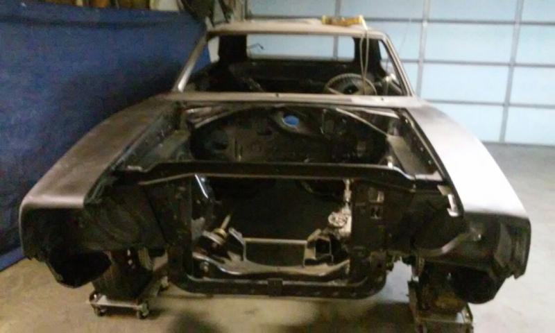

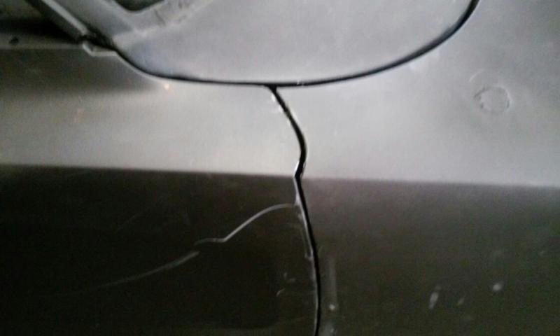

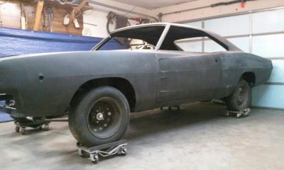

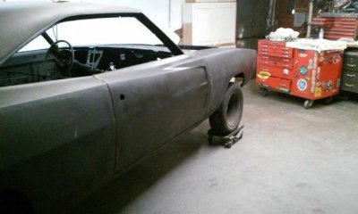

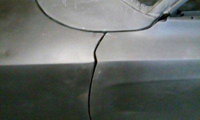

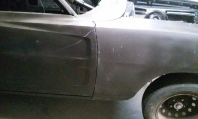

Here's some pics of the last fender going on, and the gaps. That top front driver door gap (3rd pic) kinda bugs me, I must have bumped that fender on the shop floor to much. May have to weld a tad on that.

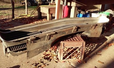

I may be de-fossilizing the grill and it's frame, etc.. next.. It is pretty crusty!

Yeap you better weld her up but at least your door to cowl gap looks nice (mine required some welding). The Charger is coming along nicely.
