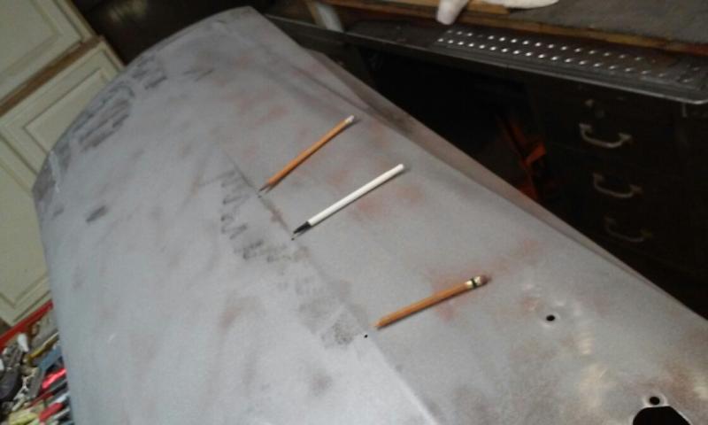

Can someone identify these 3 holes for me? Some optional trim I assume... I am going to try to prime the doors and fenders tomorrow and was doing the final prep on one of the doors when I noticed these holes. They were filled with bondo. I may weld them up.
