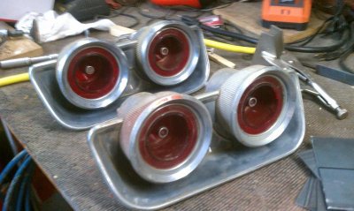

BTW , My car was missing some minor things, one was the tail-lite lens and holders. I scored a pair of whole assys today, complete- $250. Very good condition, very slight age signs.
Whats the best way to massage these back to new looking/shiny?. Mother's?

I used Mothers aluminum cleaning and polishing paste and found it to work real good, I made my need to be retired Cragers look better also with it.. They do look it good shape, those are one aspect on the 68 that makes it look as cool and sweet as they are! Always did love those tail lights...

some great info here from Marpar's GTX tail panel resto. http://www.forbbodiesonly.com/moparforum/showthread.php?43743-68-GTX-Tail-Panel-Resto
info on polishing lens'es from 696Pack here: http://www.forbbodiesonly.com/moparforum/showthread.php?37443-polishing-tail-light-lenses
search for "muriatic acid" in the threads and you'll find some examples of how that is done and how it works.

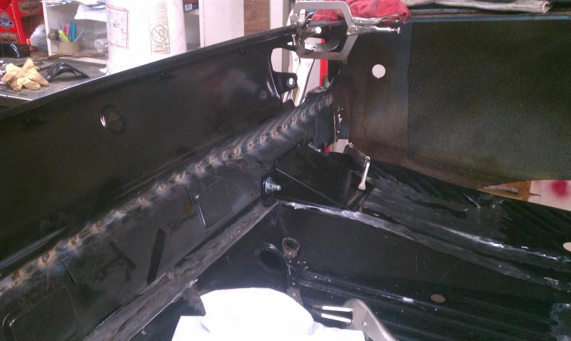

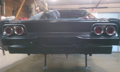

Mocked up the tail before attaching to check fit. Looked good. New stand feet are adjustable to help with measuring alignments. Had to work at real job an extra day, so that was 9 x 10 hr days, now I have 5 days of fun charger work ahead. Hope to get the tail done and start on interior floor and roll bar install.

Spot welded the tail panels together. Getting it ready to attach. A lot of measuring and fit checking.

You are doing a great job - won't be long and that rear will be back in one piece.

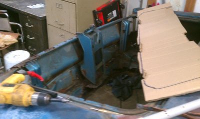

The tail work has given me some good confidence. I don't think there is anything left to do that will be much more difficult than the rear rails, tail, and trunk. The interior floor, roll bar, torque boxes, and sub frame connectors are next, then the quarter skins.

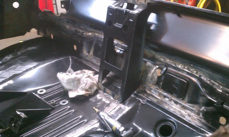

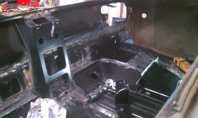

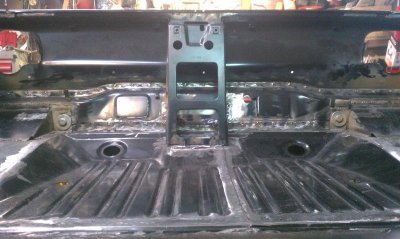

Note/Warning to anyone doing trunk rework- the center rear latch brace is not centered, I almost welded it in the center till I checked it with the cardboard template I made during disassembly.

Excellent work on the trunk and thanks for bringing up about the trunk latch. I'll have to remember that when it comes to me doing mine.

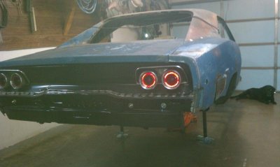

Had to set the tail-lites in for before and after shot.

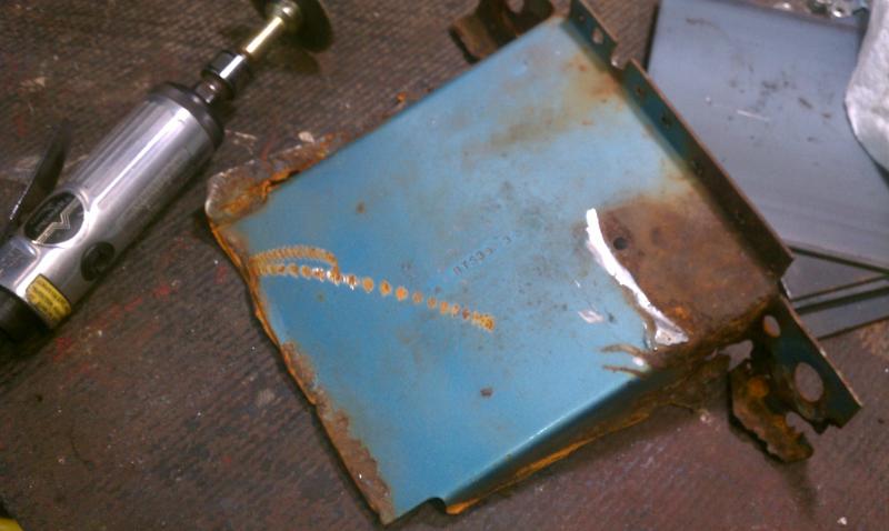

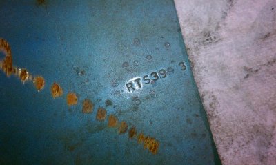

I need some help here guys, for my OCD, but I,m trying to do as many simple things as I can to make this car as perfect as I can, when I can. Here is the dilemma- the new trunk/bumper bracket plates I installed do not have what I think is a part number which is on the old ones. They are left and right and I assume the number reflects that beginning in R & L. The left says LT539 3 but the right says as you can see RT "S" 39 3. So is that an error and should read RT"5"39 3 and the guy at the factory got his S and 5 mixed up? Disregard the test/practice numbers & letters I put around the original. I meant to stamp them before I installed them and may not be able to get them in as deep as original but it will bug me to not try.
