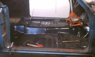

I started putting the interior floor pans in. Wow, what a crappy fit but I can make it right. Had to add a little weight to get it in place and tweaked it with my rubber hammer for a while. Marked all the areas that overlap with grey primer spray paint to help me know where to drill my spot weld holes.

Nice use of a floor jack. Improvise is the name of the game with these cars. I'm surprised you had fitment problems with the floor pan - that is one of the pieces that fit quite nice in my Charger.

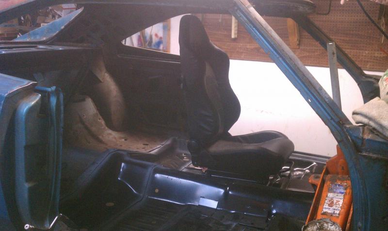

I did some test fitting with the seat mounts while I have the floor in., they were way off. I had to relocate 2 of the 4 foot brackets. I think they are going to be to low. I got them from Jegs so beware.
I have to take the floor back out and cut my spot weld holes which will be hours of fun. But I am trying to plan where the roll bar will mount. To do that I need to put at least 1 seat in.

Well, it looks like the seats and mounts are going to work, with minor mods. It was kind of motivating sitting in the seat., thinkin this is about the same height I'll be when I'm pullin a wheelie. I think I may need to put the steering column in just to check the seat position also before figuring out the roll bar mounts. Maybe the pedals too!
After further analysis, the seats would be to high with the Jegs mounts. Unless I mod them even more. Sitting in the seat as it is in the above pic, my head was 1 inch from the ceiling. I may try them mounted directly to the floor. That would give me about 3 more inches.

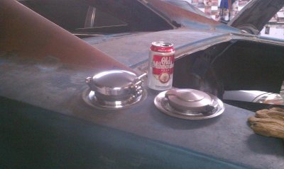

On another note, I saw this Mooneyes gas cap on a charger in a link on another thread and had to have it. I know some will say I should use the stock one, but I plan on doing a lot of things different than stock on this car. Anything that I do different I am going to try to insure it can be easily put back stock, and I am going to restore and save the left over stock parts in case I ever sell it.
Yea, I thought the $400 one is a little more trick/modern looking also, but $240 for the one I got was more than a sane man would pay. That was one of your threads where I saw it on a charger, thnx sf. A stock one is $145, with dish.
I hear ya lol, I might fork over the money for one down the road when the car is driving and the bigger fish have been fried. How was the fit when you test-fit it as far as the dish piece matching up?
I don't think it would work or look good with the stock dish. It fits good in the reccess by itself.
