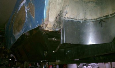

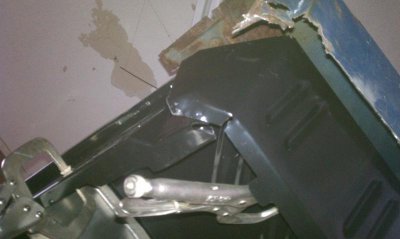

I could use some help guys,. If anyone has some pics or knows a link of some detail shots of the trunk drops install I would greatly appreciate it. I am test fitting the trunk floors and having trouble figuring out the some of the proper alignments. My original stuff was so rotted or gone I can't tell for sure on some of it. My new tail panels and corners are due any day which will help, but even then I would like to see it before I do it. 1968 preferably, since there are some minor differences with them and the laters. Here are some pics of the areas I need to see>

Ahhhh, not so distant memories. I see your having some of the same issues I had, Unfortunately I wouldn't weld in the trunk drops in until the quarters go on. It all has to line up at the same time, including the quarter corners that are a real joy. It's a puzzle and you need all the pieces to put it together. I did get the trunk pan in first though. You should be able to get a good alignment with what you got in so far. I had to do some trimming and get creative to get the drops in right and the corners in. I would get the pan in and just make sure all your measurements are even on both sides and line up good with your rear seat pan and wheelhouses. If your still nervous just tack the floor pan in until you get everything on, TAKE YOUR TIME, it get's exciting getting panels back on but double check everything. Check out SGT Paul's thread, he documented better than I did with good pics. Good luck. If you want specific pictures I can try and get some for you tomorrow.
http://www.forbbodiesonly.com/moparforum/showthread.php?15210-SGTPaul’s-68-Charger-R-T-project
looks like you are moving right along. I am going to be start the restore on my 72 charger i got in pieces. i found it on craigslist some kid wanted to trade for a jeep. so ill be checking in and good luck
We had some issues with the fitment of one of my drops. Took some creative cutting and bending. Definately get the quarters and corners (you will have fun with the corners) in place first. The drops were the last piece we welded in. Not sure if this is correct, but it seemed to be the easiest to us.

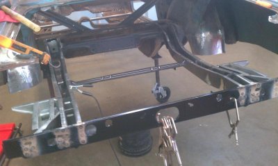

Well, I did my 8x10 hour nite shifts (at my paying job) and it's time for another 6 off-days and nites of fun. I got all the tail-panels, etc., this week. They look really good but I can tell I will have to tweek them in spots. Here is a pic of where I am, starting back where I left off.
Everything test fit good so time to let the sparks fly!:th_krazy:

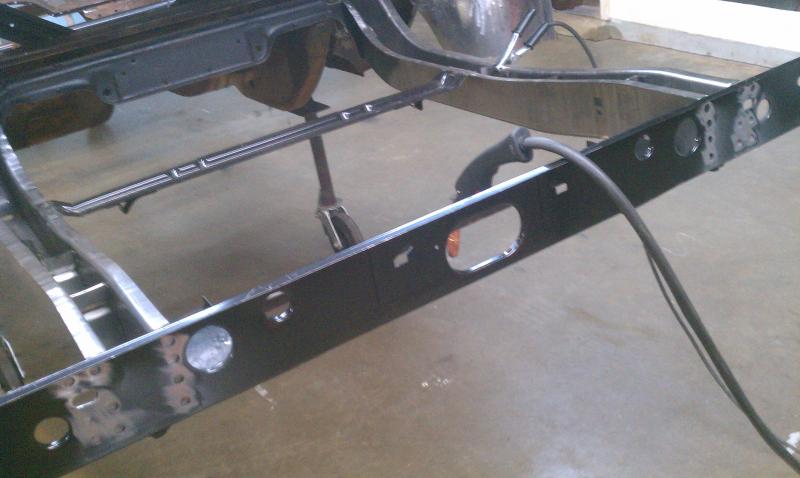

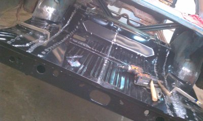

Rear framework done. Shackle brackets took some tweaking, they did not won't to fit right. I had to beat, bend, grind, etc., before they went on.
Now, FINALLY, time for the trunk floor pans.

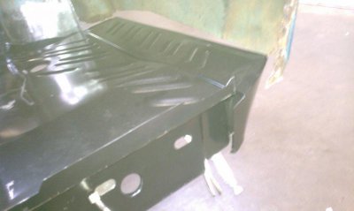

Didn't get as much done as I wanted during these days off, but I never do., lol. Prepping the trunk pans took forever. I didn't space my spot weld holes far enough apart and ended up drilling over 400 holes, wayyy too many, dang my arm is killing me. Also test fit the tail panels.

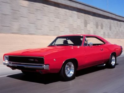

I'm getting to the point where I need to decide it's color and would like some other opinions. I'm undecided between red or black?, stripe or no stripe? R/T clone? What's your favorite combo? Here are a couple of examples of each that I like.
Both cars are awesome. If it was me, I would lean toward the red w/stripe. But you gotta go with what you think fits your style.
Well that's always a fun decision, picking the paint.....If you're like me, you'll go through about 10 colors before finally just pulling the plug on one...lol Red would look sharp, black would look sharp with a matte black bumblebee stripe. Just about went with Ford Performance Red on my Bird:
I like red, But that black on a 68 Charger looks absolutely killer, You need to go with what makes you excited when you see these, like the two you have pictured and its just my opinion that the black is the choice with the two colors you are thinking about. Color and wheel selection is two of the hardest things to deal with on these cars and everyone has a favorite, I would think about the wheels your going to want and try to picture them on both these colors, It may help you decide which one suits what your after.
Personally i don't care for the scoop on that black one, the factory one looks best.
Thnx guys.
Both equally great choices in my mind. I would absolutely go with a 68 bumble bee stripe as they look awesome IMHO. the black bb stripe on a black car should look cool too. As far as R/T clone goes sure why not and the R/T badges will look really sharp on either color. Red and small chrome accents on a black car really pop. And Red on Red pops too, even on my tired old 68 R/T. I think so anyway.
