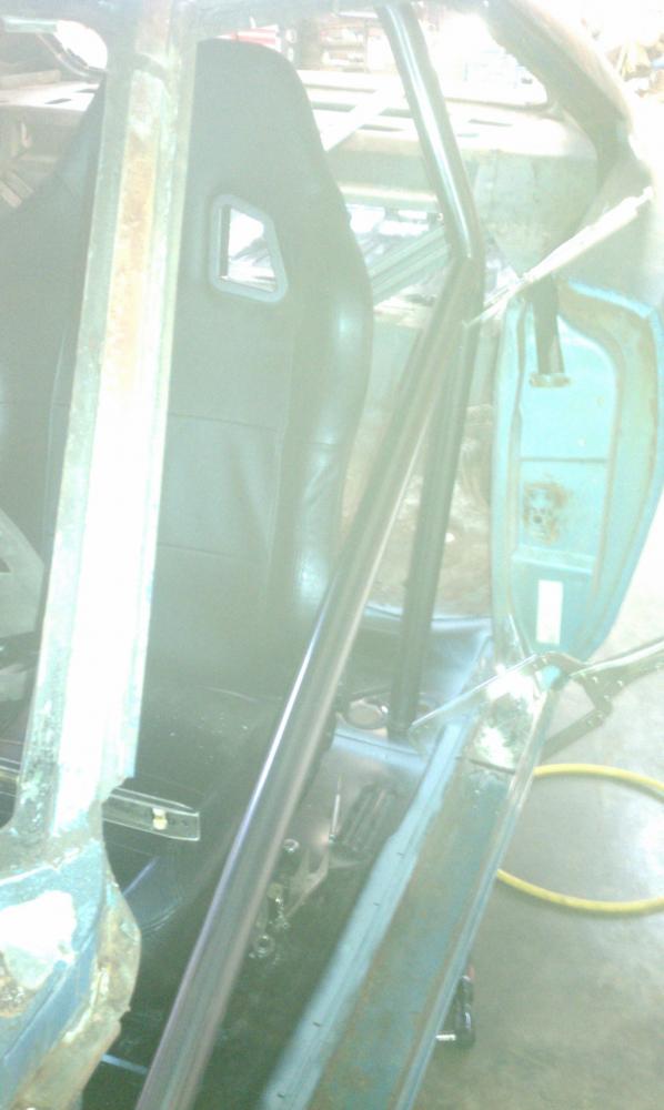

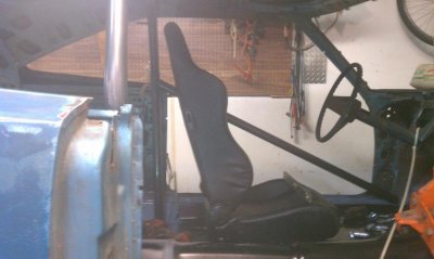

I test fitted the roll bar with seat and steering column. I'm trying to figure out and plan where the bar will need to mount. Checked NHRA rules and I think the way I have it mocked-up will be legal when installed. I didn't have all bars in place but enough to check fits.

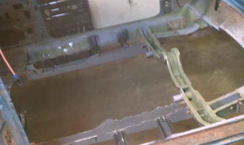

I have not made a lot of progress because I have been sand blasting the frame work below my floor. I have blasted there enough I think. My air compressor is not big enough to do it swiftly so it has been slow going. I have ordered a new air compressor which I beleive will do the rest of the car as needed better. It is a 5hp dual stage, 60 gal, 11.5 CFM @ 90 PSI. I may get a better blaster also, for the rest of the car. Now I will apply the Eastwood inner frame paint prior to installing the floor. I will start drilling the spot weld holes in the floor pan/s this week also.

The new & better compressor will be nice I'm sure, I just burned mine up recently too, I will be getting a new one or rebuilding my old one, soon I hope... I've been using my little portable Ingersal 6 cfm 100psi 5 gal. pancake tank/construction site compressor lately, it takes allot of extra time, to let it recover & build pressure, when using any sanding or grinding tools, that need allot of cfm & air capacity... Good luck & I like the project, keep up the good work...

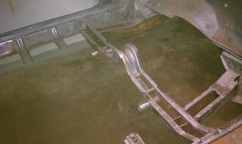

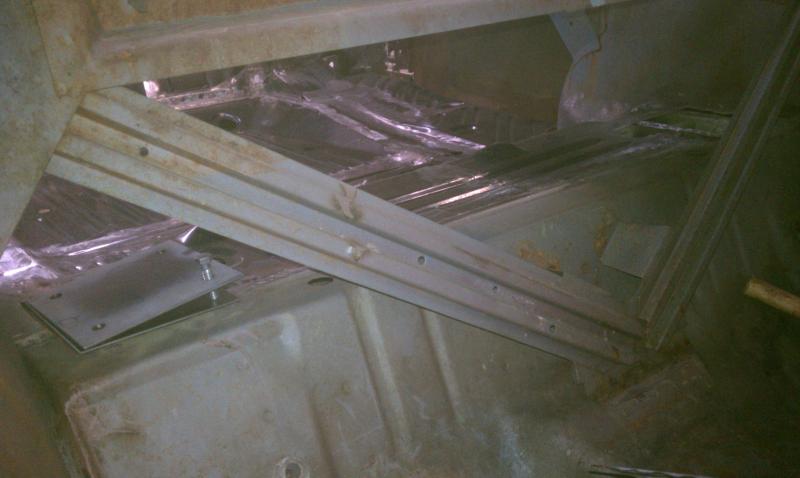

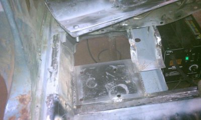

I've made some progress on the floor install prepping. I tak welded the sub frame connectors in to help with the roll bar connections. I am going to bolt the roll bar/s in so that if I sell the car someday and the buyer doesn't want it with a roll bar it will be easily removed. I followed the NHRA rules and this is how they said I could do it. But I am going a little further with the strength,, for the main bar I'll weld the bottom (thicker than required) sandwich plate to the rocker and the frame connector. The rear support bars will bolt to plates welded to the splice joint of the rear frame partials, thus giving the splice more strength also. The front bars will bolt to plates welded in the front corners of the floor/rocker area right as it starts upward. Everywhere possible will just be tak welded till car is loaded complete as far as weight and sitting on tires.

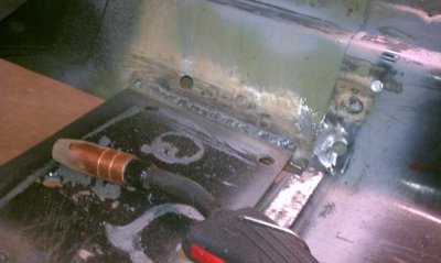

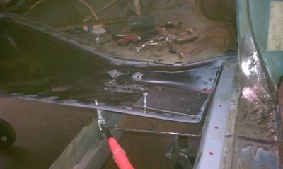

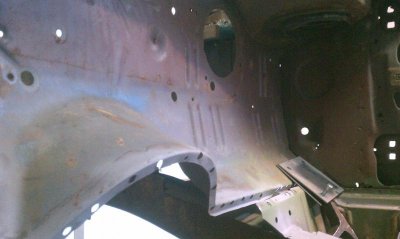

My floor install is going good.. It's been a pain figuring out the best way to mnt my roll bar, but I'm pretty happy with what I came up with, and how well they fit and tied in to the framework. I made these mnt plates for under the floor, which had to go in after the main floor went in and before the rear foot wells. Finally gettin some decent lookin welds going.

Looking Good! I agree, looking better the more on and on you go. Best way to learn amigo. Keep up the good work, you're doing great!
