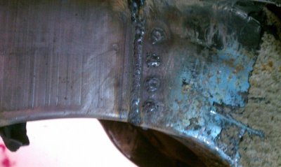

I am welding the new rails on, letting the welder cool off now. Here is a pic of the splice on one side, just about finished, before grinding. I drilled 3/8" spot weld holes in the old "left on" rails at the splice to increase the strength as much as I could. I skipped from side to side welding a little on each side to help prevent warping.

I'm guessing that you spot welded on both sides of the rail and then ran the full bead all around? Looks good, you'll have to show us the full picture when you get both of them on.

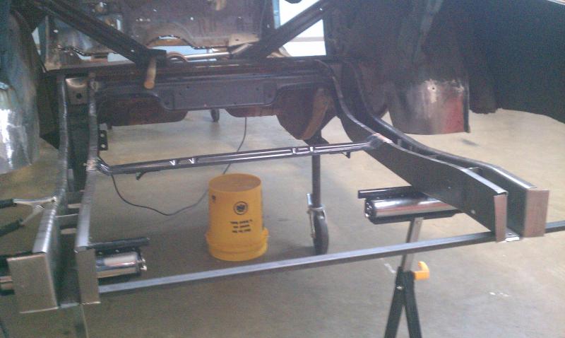

I actually put both sides on at the same time, as a "unit". Skipped from side to side with small welds to keep warping to minimum. I took the old ones off as a unit as well, as you can see in the pic in post #58. I welded temp angle iron braces on old and new so the alignment would be exact. After I welded a brace on the old ones, I cut off the shock mount cross member to reuse it. I laid the new rails splice ends to the cut ends of the old ones, then tack welded the shock mount and the trunk brace to the new ones. Then put the new "unit" in place and tapped them/it into place while checking many measurements I had from the old ones before I removed them, Height from floor, distance between, side distance to wall of shop, etc., etc.,. I used a plum bob to mark the floor, center of back end of rails and used also it with other floor marks to insure car did not move. "Too many measurements are almost enough". Then started finish welds.

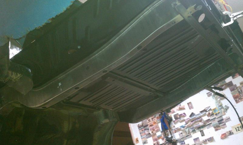

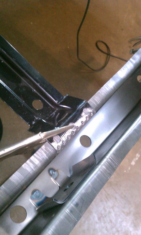

The operation was a success and the patient is resting comfortably. Grinding of splices revealed no holes. I'm sure with a little por-15, paint, and maybe some undercoating you won't be able to tell this repair ever happened. Test fitting of rear cross brace and trunk floor halves is going good. Will be ordering the tail-lite panel, rear valance and a few other smaller parts soon. I noticed that the tail-lite panel is a good bit cheaper from RPC/Sherman than from AMD. Is quality ever an issue with Sherman parts?

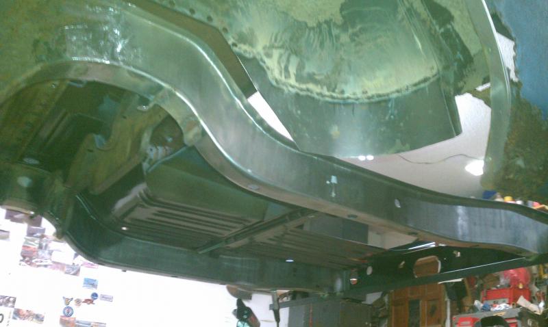

rgr tht, will go with bullet. Another pic of the rails>

Looking good. You sure don't waste any time on your days off. I feel the same about the POR 15, having had it peel off in sheets on both clean metal and e coated stuff on previous cars. Went with Props' recommendation for Rust Bullet on my Charger.
