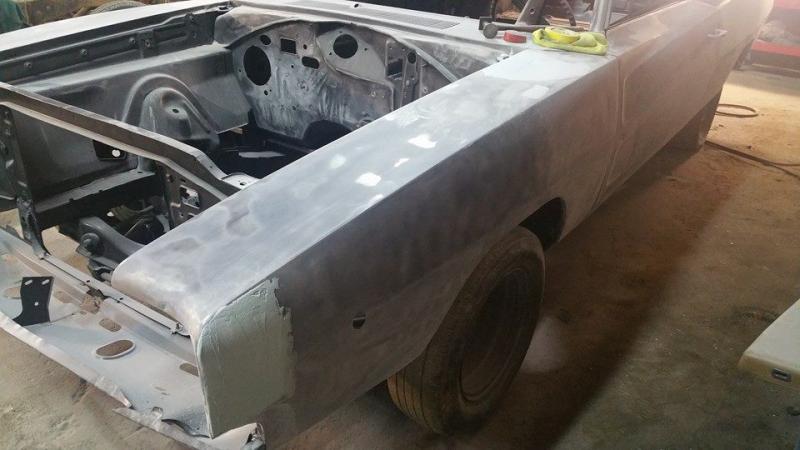

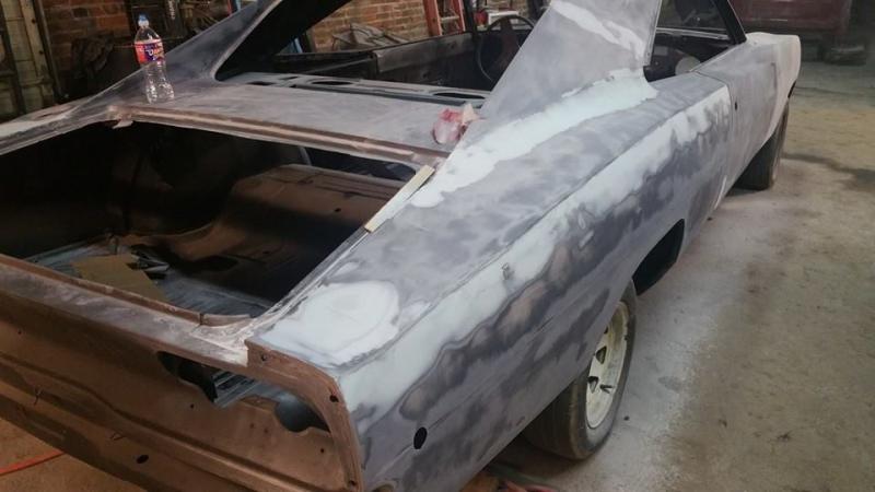

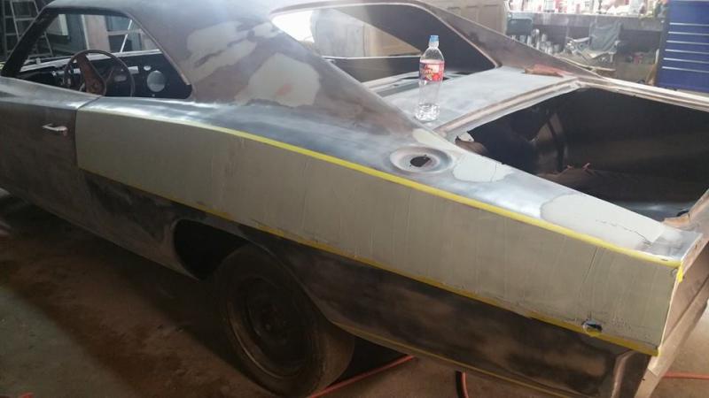

Got some more body work update pics today. Holy Mackerel that's a lot of bondo, and on a new panel! lol..

make sure they have the 1/4 panel extensions, the u shaped end caps, so they can be fitted properly.
I did, thanks Charlie for making sure tho.. Even bought new oem gaskets and attach nuts. Also gave them the stock trunk lid to check fit with the extensions. But I'm not getting the stock trunk lid or hood painted because I'm going with glastech ones which I'll bring back to get them painted later, may leave them flat/stealth black for a while. I cleaned up the stock trunk lid and painted it with the "all u need" primer and will store it away along with a lot of other parts I'm not using but want to keep.

Might want to get the fiberglass to them. I've had Fiberglass stuff that didn't match steel parts.
Yep, good point. I should have bought them instead of the dash pads and gauge cluster, now my funds are too low. I still might have time to get them before he shoots. Originally I thought it would be less work for the painter without them now and help keep my bill lower. But they won't need much prep so maybe he'll do them for a tad more.

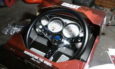

Look what Santa brought. I like the old classic Grant style. Had one on my last mopar 30+ years ago. The n2o button will fit nice in the small hole by my thumb. I also had one like this set-up with the button on my drag boat.

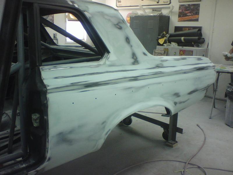

If you want it straight everything ends up being coated. Bondo is less brittle and cheaper than primer. We always start with a skim coat.
Doug
Yep, I agree. I knew mine would need a lot and/or skim coat. I gave them 4 gals to use on it.,hope it'll be enough.lol
