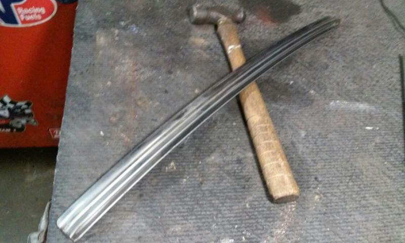

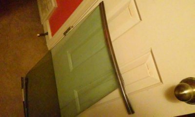

I need some help finding something guys. All the side glass windows were good except for the passenger door. I will be buying a new glass and I have the stainless trim/seal holder for it that goes on the rear vertical edge. It has the rubber seal on one side to seal between the door glass and the rear quarter glass when rolled up, and I believe I have found those. On the other side of the trim is a U groove for the door glass to attach into that had a U shaped plastic strip in it, glued in I guess?. I have been searching for those plastic U strips and not having much luck. Anyone ever deal with these and/or know of a supplier?
Here is a pic of the trim piece that came off of the broken passenger window and a pic of the good driver door glass with it's trim piece on it.

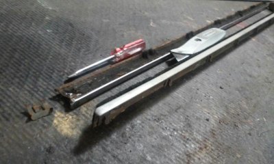

And while we're at it what's up with these, I think they are called cat whiskers. And I think I see places with them for sale, but wonder if you get the whole metal piece which has a chrome/ss strip on it and mount clips, or do you just get the new fuzzy pads to glue on, after you scrape off/clean the old ones which might be tuff.
I also posted this question on the "restoration" forum and BeeKeeper had the answer. Thanks again BK! Here is a vid that explains "glass setting tape".

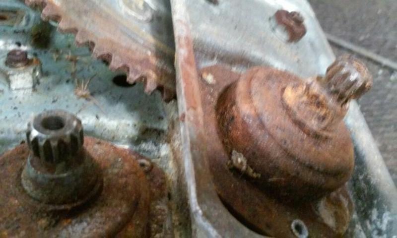

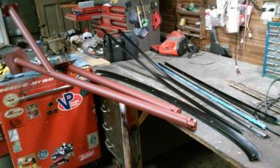

Yep, time flies. The only thing slowing me up is financing. But I'm still plugging away at what I can. Found some stuff to work on today. The front window regulators were froze up with rust so I refurbed them. Anyone working on these BEWARE, removing the coiled spring will hurt you., ask me how I know. I pried it up and off with a screwdriver and when it let go it almost got my knuckles. One spring was missing and it appeared someone had tried to weld the splined handle shaft to keep the window up. I also blasted and painted some of the roll bar parts and some of the interior trim. Everything turned out good.

Nice Kid. I'm working on my window parts now to. Blasting and painting the parts. I had bought a lot of different paints from Eastwood to try to replicate the look of finish. Believe it or not the aluminium engine paint I had in the cabinet looked the best. Now I know it'll probably never be seen. I tried to only blast just enough to remove the rust. The alum. paint blends pretty good with the galvanized coating.
