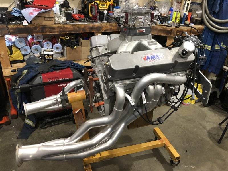

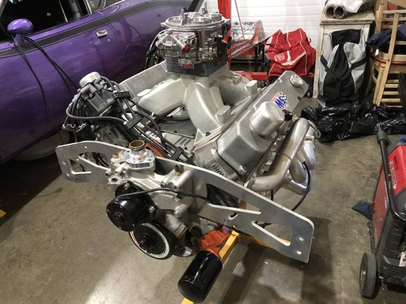

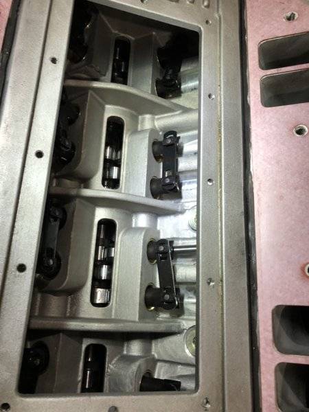

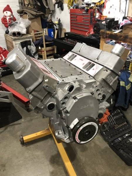

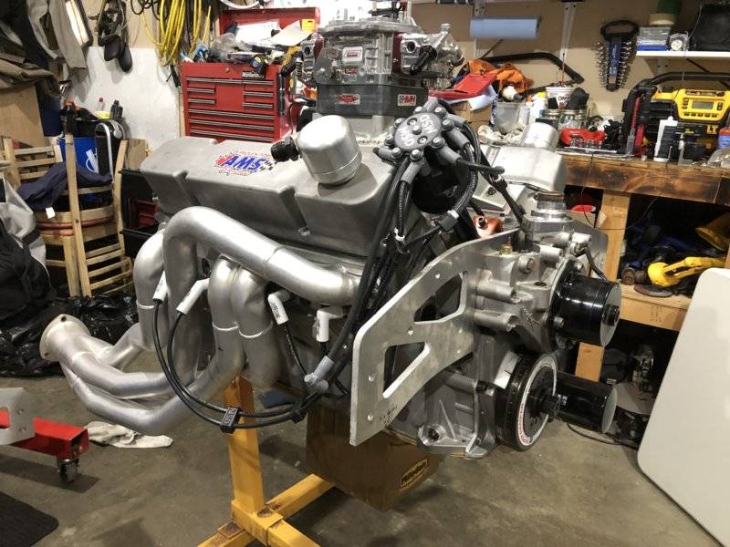

Took some time today to test fit things on the World Block. I was surprised. The intake side is very tight to clear a pushrod. It actually clears better in a center cup lifter vs an offset. If I wanted the pushrod running straight with an offset lifter, I have lots of clearencing to do. So probably run a center one and have the pushrod on a slight angle.
All in all it looks pretty sweet.
954E4FE8-8BCB-47C5-B440-EAB0614BFCF8.jpeg 4B2841C4-531C-4B97-98E3-B8AD51B066E5.jpeg 0801D06F-2E9D-4D6D-94D7-761054C5207E.jpeg 93D403F6-0024-4F66-9383-22268C4CB555.jpeg 4BFD1279-B46E-43A8-A2CE-CED97923134A.jpeg 129EF1E4-359C-4DE8-BAA5-4F8344159488.jpeg
Looked at my picture again. Thought I took a photo of the pushrod on the intake side, but I only took one checking the exhaust side.

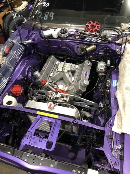

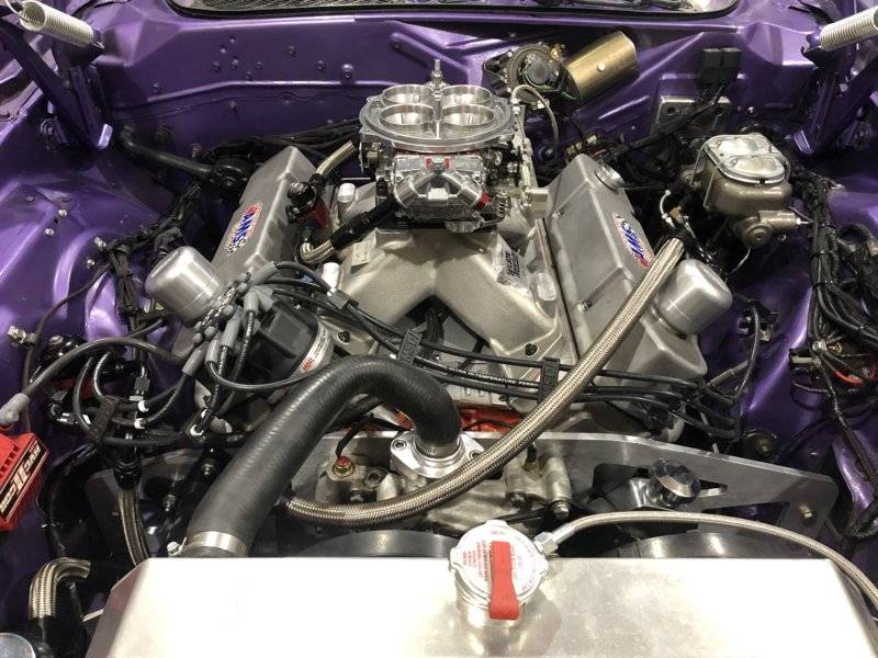

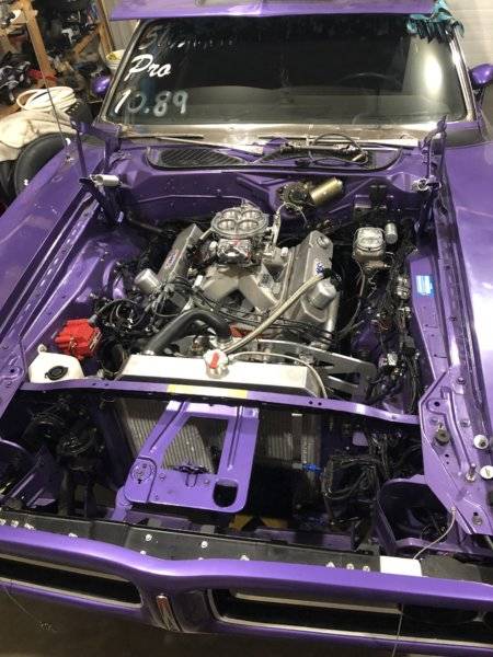

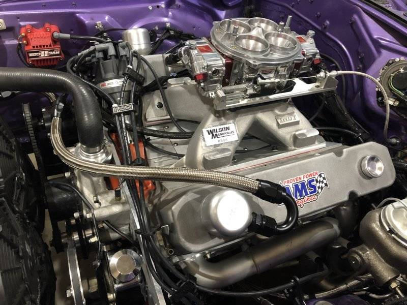

Today’s progress. Will be running Monday sometime.

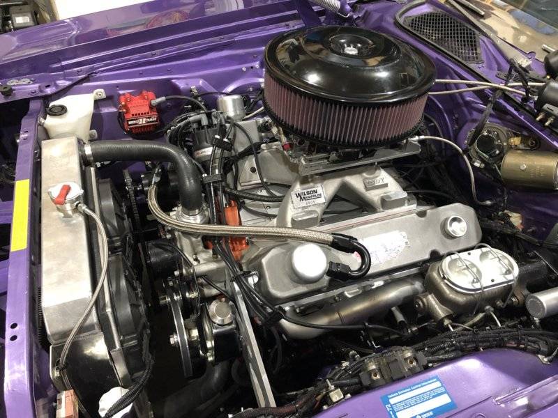

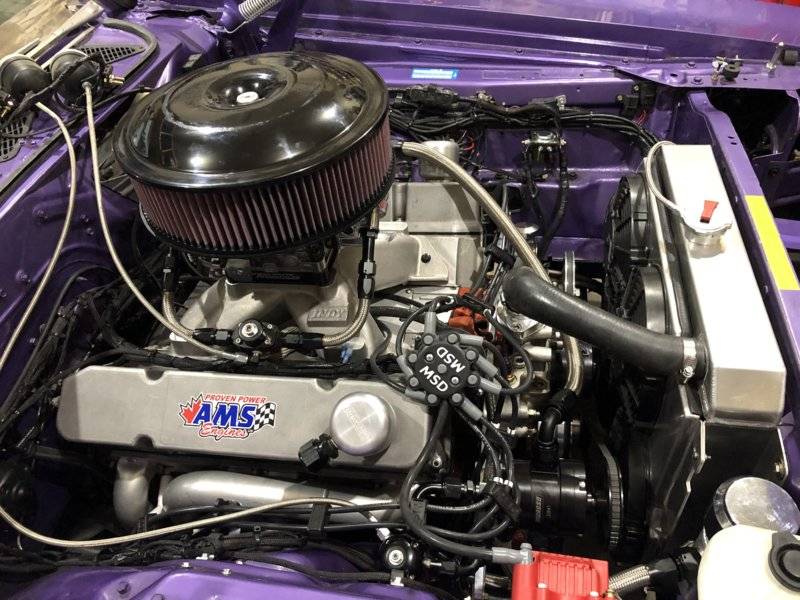

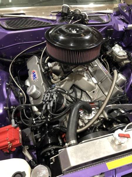

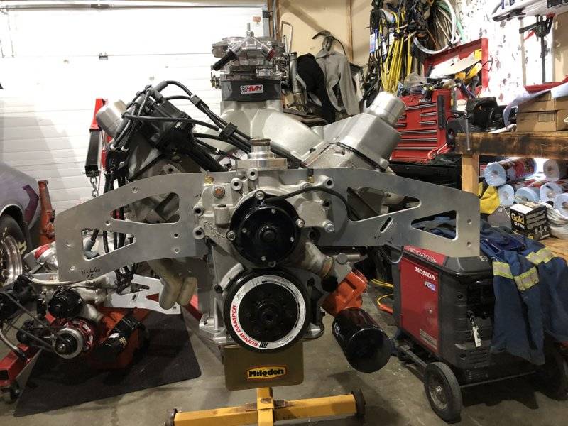

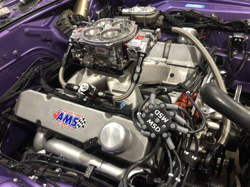

It came alive yesterday. Have a bunch of checks and tests to do yet, but it is real close now. Gonna swap out the crank trigger bolts to Allen head so it is easier to move on the bracket. Everything is pretty tight there with an alternator bracket partially covering the one bolt head. Makes it impossible with a wrench. So these Allen head bolts should do the trick. Only run a few seconds at a time so far while I was messing with the timing, but sounds good so far. Once I make the changes to this bracket and get the timing where I want it, she will get a good warm up and check all the functions and leaks.
