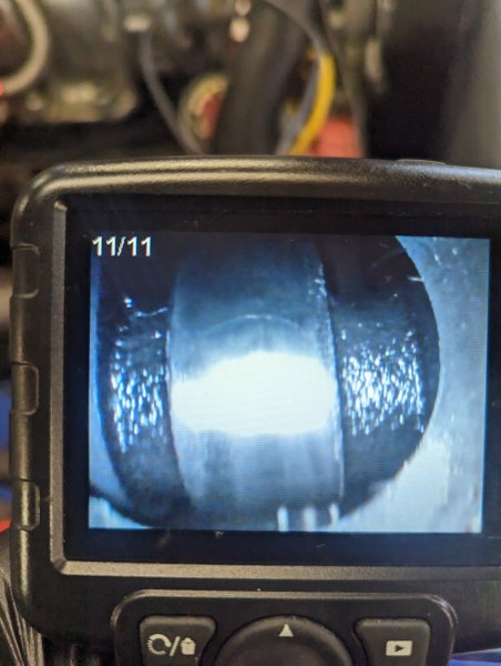

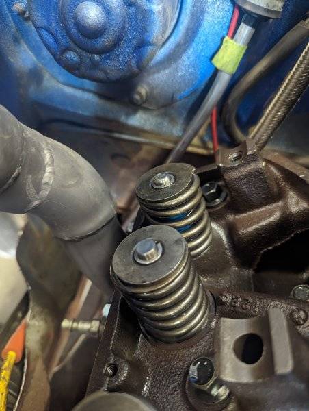

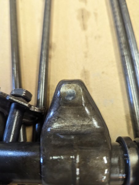

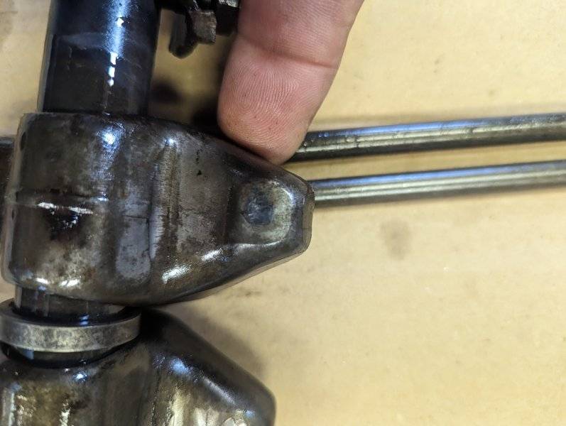

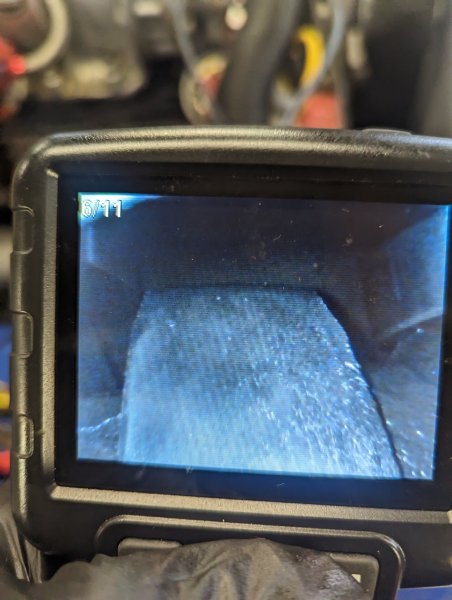

So after the normal break in procedure. This is where I'm at. Only one lifter collapsed. I have decided to try again only with roller hydraulic lifters and a roller cam and the other details to make that work. My question is I am unsure why a couple of the valve stem tips have a taper on them. See pictures. Also, I thought I had the rocker arm assemblies in the proper orientation. See picture also. Thoughts appreciated

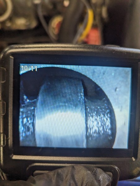

The first picture is the lifter that is mated with the valve stem in question with the taper.

Looks to me like the lifter that failed was not spinning in the lifter bore. I have found out how critical the lifter bores are to ensure survival of flat tappet cams during break in. A burr in the lifter bore can cause this. I'm not saying definitively that was your cause, but that is my guess. Also, anymore, I feel like you need junk, weak springs for flat tappet cam break in so the cams/ listers survive.
By switching to a roller cam, these issues will essentially all go away. You do still need to make sure your valve spring coils will not bind with whatever cam lift you go with. You will also need to clean and check your engine for debris from the failed cam/lifters.
You said the valve stem tips have taper on them? This is hard to see in the pictures. Did you check your valve train (especially pushrod length) to be sure the geometry is right?

It was only that one lifter that was bad and it was just two of the valve tips that had slight tapers to them. It was stock pushrods and stock rocker arm assemblies. In post number three, that is the cam specs of the cam that I used..
With the pics of the valve stem and the rockers... Anyone see any reason it would have did that? It's only on two valve stems
Those valve stems didn't wear like that at start up. They were like that from install. Who did the valve job?

A machine shop I've used many times. I didn't pay much attention because it's they set for several months before I decided to use them. I didn't see or think of any way those rocker arms would have done that. If you look at one of them, you can see where the rocker arm was riding right in the center where it should. They're stainless steel valves
A collapsed lifter is a different issue than one that wasn't spinning and flattened out the cam lobe....and did you look at the rockers before this all started? Rockers (and push rods) are a wear items too and need to be inspected if they are to be reused. These days you got to inspect every little detail on all the parts....shouldn't be that way but it is. I've seen new lifters right out of the box that looked like garbage.

I guess I didn't pay much attention to detail as I should when I bouldered the rocker assembly on was too worried about getting the rocker arms oriented in shaft and the proper orientation. Does anyone see any reason it would hurt to run those couple of valves that look like that the tops are flat was just a little mark where the rocker arm is

See the pictures in post number one. That is a camera that shows the lobe on the cam. It's not completely rounded off at all, just a little metal transfer and it's only on one lifter
Metal in the engine even if a little needs to be investigated.....taking off a main cap or two isn't that much work to see what's what. I like to start in the rear mains.

Does everyone agree that my setup didn't put a bevel on a couple valve stems?
