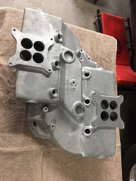

i heard that the Hot set up from back in the day goes like this,,use stage 2 heads with a stage 3 intake. because the stage 3 heads r just stage 2's with the machined changes cast in..and of course the xtra 2 bolts for the valve covers/rocker stands..
my stage 3 intake before painting,,,casting date 5/7/63.
