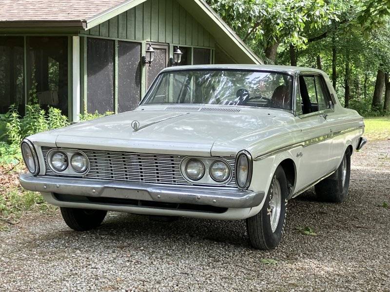

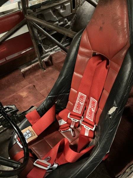

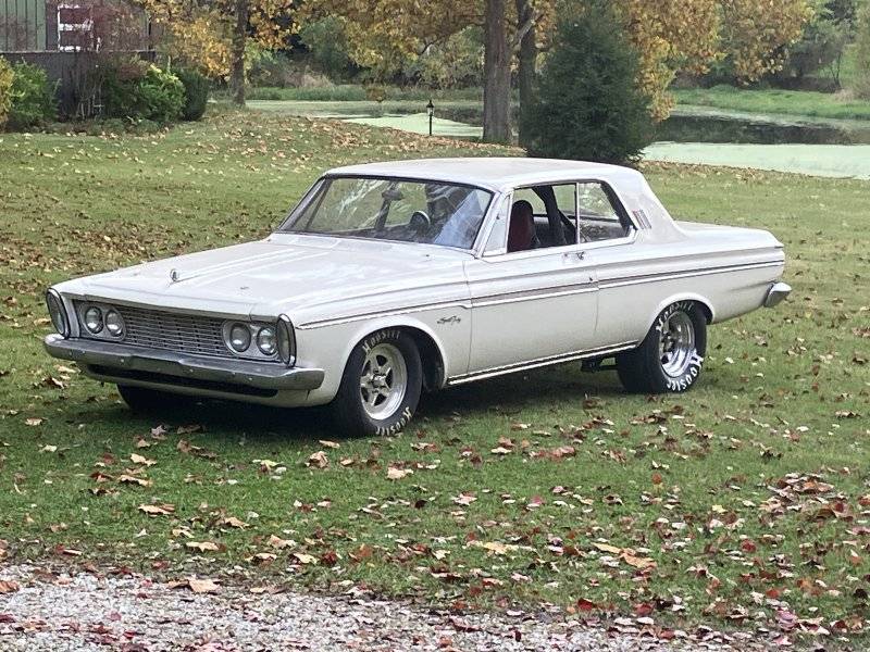

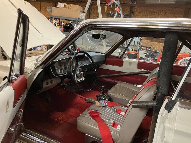

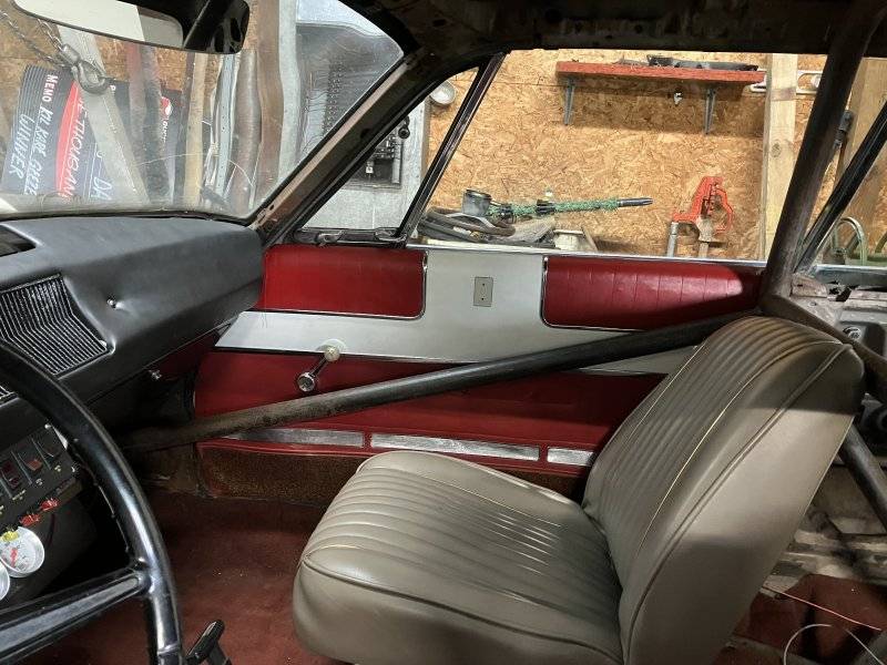

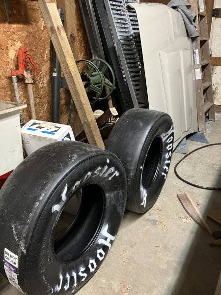

Making some headway...talked to a guy about doing the interior work (carpet, headliner, door and rear panels) he's going to stop at the house this week to check it out. Bought new Hoosiers since the old tires lose about 5 lbs. of pressure a day. Fired it up to check for leaks (radiator and fuel pump, so far so good) still need to hook up the tach, change oil ( still has break in oil) bleed brakes, clean up some wiring. Bought some A-990 bucket seats from a friend...would like to get her out for some T-N-T in July.

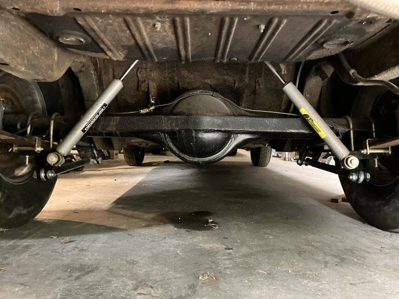

What do you have for a rear end setup. I still have my tapered axle 8 3/4 back there.
Braced 8 3/4 with Moser axles and 4.56 gears. Don't know what year b body the axle housing came out of.

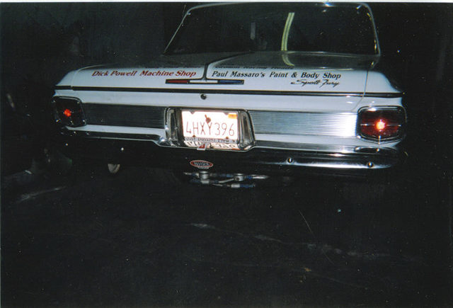

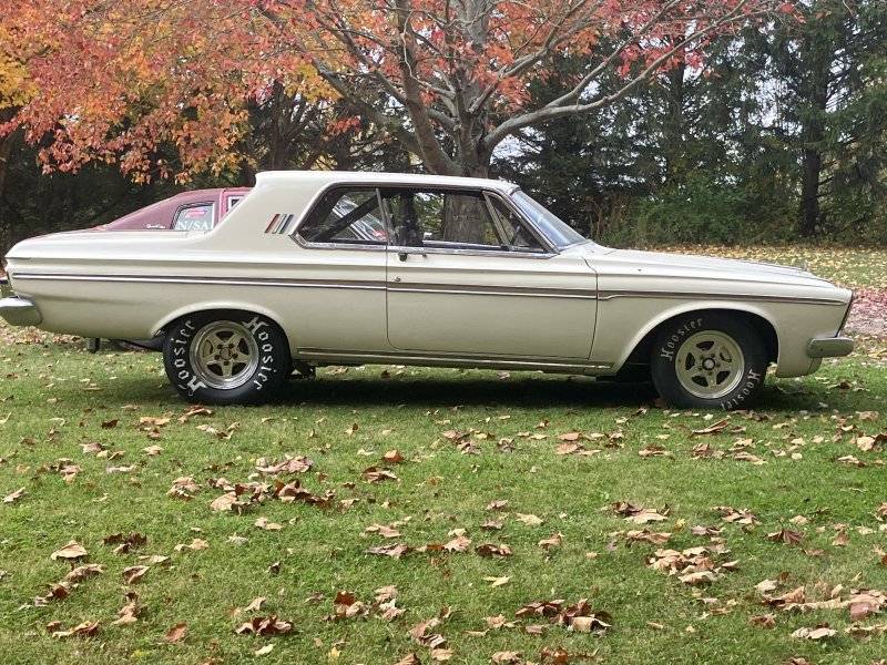

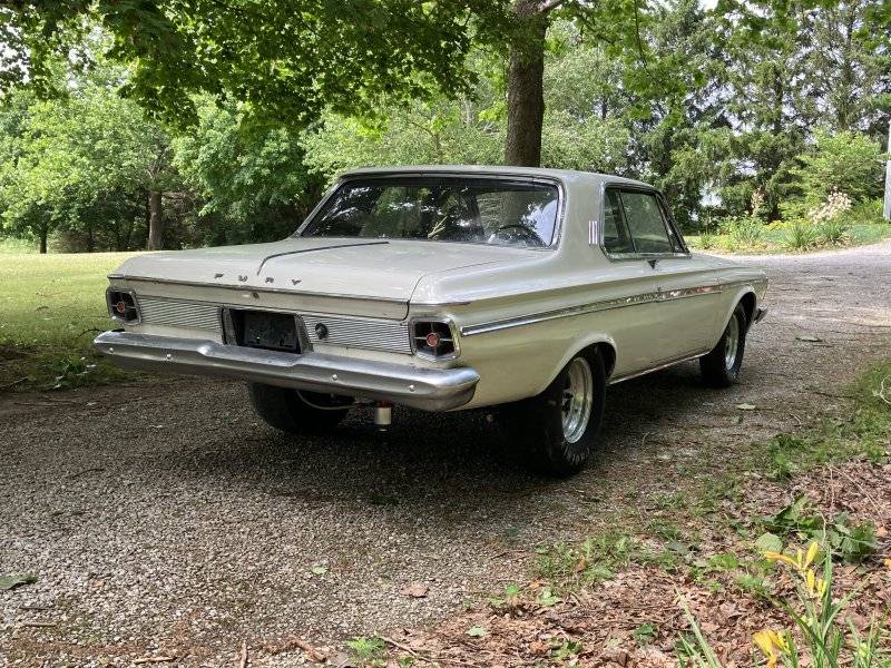

my 63 sport fury golden commando with a hot 383 single 850 cfm carb ran 11.73 in the quarter , 4.89 rear gears 727 with a trick 5k converter , and a 8k redline cam . stock block , rods and crankshaft . it had mw heads with a customized single plain intake of the day , back in 73 . it went record in ihra event . we have been running it with a soft c/r 440 for pump gas with mw heads and intake , as a street / strip car running 11.80 off the trailer with bfg drag radials through the muffers with 4.56 in the butt . oh ya 6 blade steel fan mounted to the waterpump , brass radiator , miny alt and reduction pulleys . just like a street car , lol .
can't quite see my 8 3/4 bracing , but it was done from center of both springs across . the shocks are vertical mounted to the side frame rails . and had tobe moved more to the rear because the brace bent both shocks on a hard lunch , lol . live n learn .

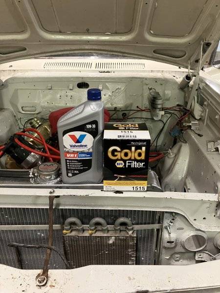

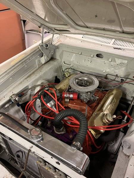

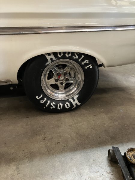

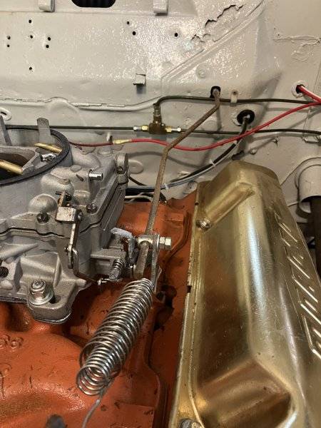

Oil and filter, fresh belts, fresh Hoosiers, tach mounted and hooked up, fuel cell vented. Can't live with this throttle linkage though. Still a few tracks open through Oct. for test n tune. So close...

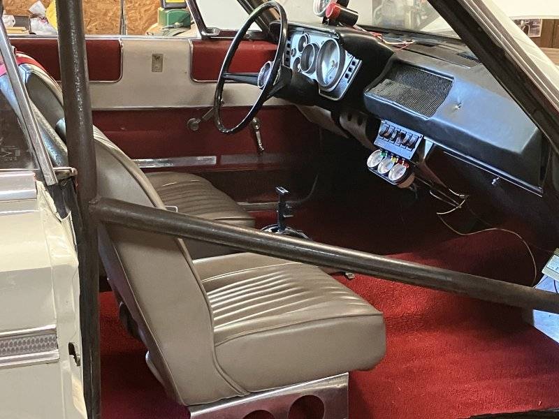

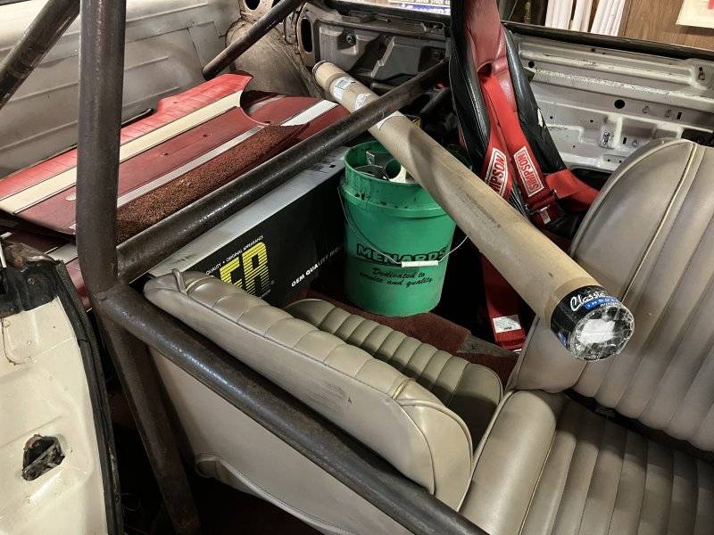

Haven't updated in a while...finally took the car for upholstery work. Also working in the engine bay as well. Torque strap, battery needs to be moved up front for stock eliminator and have to put an alternator on for the same reason. Also bought some TTI 1"3/4 primary long tube headres to replace these short welded collector headers. Want the option of adding collector extensions. Gettin there...
