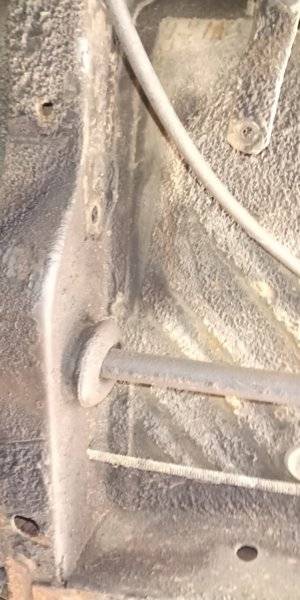

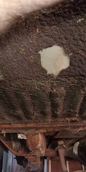

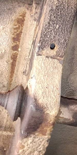

Here's a couple pictures of the torsion bars to the frame.
Looks to us like it has some type of undercoating on it. You can see some spots where it's not there and it's clean metal.
