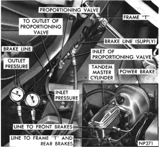

          Old hoses are definitely an issue , change them ! I miss understood, thought you said they looked replaced, you can re-center valve - remove brake failure light switch and a small pick tool etc will get you down in there to move back to center - it's a small rod w/detent the switch sets down in , you need to center it and hold it there until you have pressure in lines at both front & rear - it's a safety valve to try and save you some brakes, but they will move if being too aggressive bleeding - it thinks there is a leak and slides to close off front or rear - you can look up a diagram to get a better idea what you're working with - good luck

          Interesting...this is the first time I've heard of being able to do that in these, is this only the 66 single master system?

          Hey thanks for that. What is the valve called name wise so I can find the diagram? Or if you have a good lead where to find it that would work too.

          I believe hes talking about the proportioning valve. It's that brass block below the master cylinder that the line goes into.

          Ours doesn't look like this. Ours has a bronze block to split and in the documentation I can find it talks about disc brakes and we have drum brakes.
