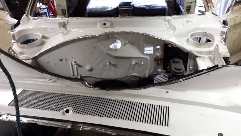

    If the car is from Georgia/Tenn I would think the cowl is more likely to have evil level hiding rust than the rails.
    This 67 cowl had pinhole in the top right over the stand pipe.
    The bottom was starting to pinhole rust in one or two places IIRC, but still solid enough to save it.
    Floor tip on cars.
    Use an ice pick to probe through the carpet.
    Leaky wiper seals sometimes.

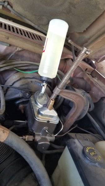

    This car MAY just have a distribution block OR a combination valve OR a proportioning valve.
    Check here.
    https://www.musclecarresearch.com/mopar-parts
    Where are you in the brakes?
    Is it a new master cylinder?
    But do you have an air compressor?
    This is the best thing I've found.
    The "trick" is to aggressively push the peddle down while doing the sucking part and slowly letting the peddle back up.
    This seems to do two things.
    It seems to clear any debris in the system.
    You will see this trash in the collection.
    It will force any air pockets on through.
    You can make one of these to match your master cylinder and it will prevent the fluid from splashing while you "pump" as I've described.
    Stand pipe in the off side while working the other side.

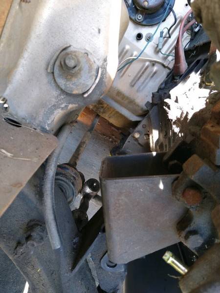

      The problem we are having isn't whether it drops in, we need different motor support brackets. We need to find the right brackets for the 66 frame for the 360 motor.
      It's possible it's just the difference between truck and car switch but we don't know for sure.

      Small block brackets should be the same all the way to 1972.
      However, the 273/318/340 bracket is different than the 360 on the driver's side.
      The boss on the block was moved about 5/8 inch.
      360 brackets are kind of hard to find.
      Lots of folks use longer bolts and stack up either a lot of washers or a couple larger nuts or a spacer.

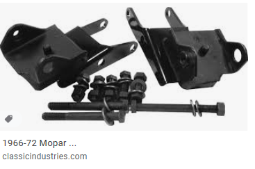

      Your truck motor mounts are not the same as a b body. The b body mounts hug real close to the engine block and down below the block boss bolts. I don't have a picture handy but you should be able to google them
    • dsd1967
      dsd1967 Well-Known Member
      Messages:
      820
      Likes Received:
      367
      Joined:
      Mar 6, 2011
      Location:
      Toledo
      Local Time:
      8:17 PM
      Something like this
