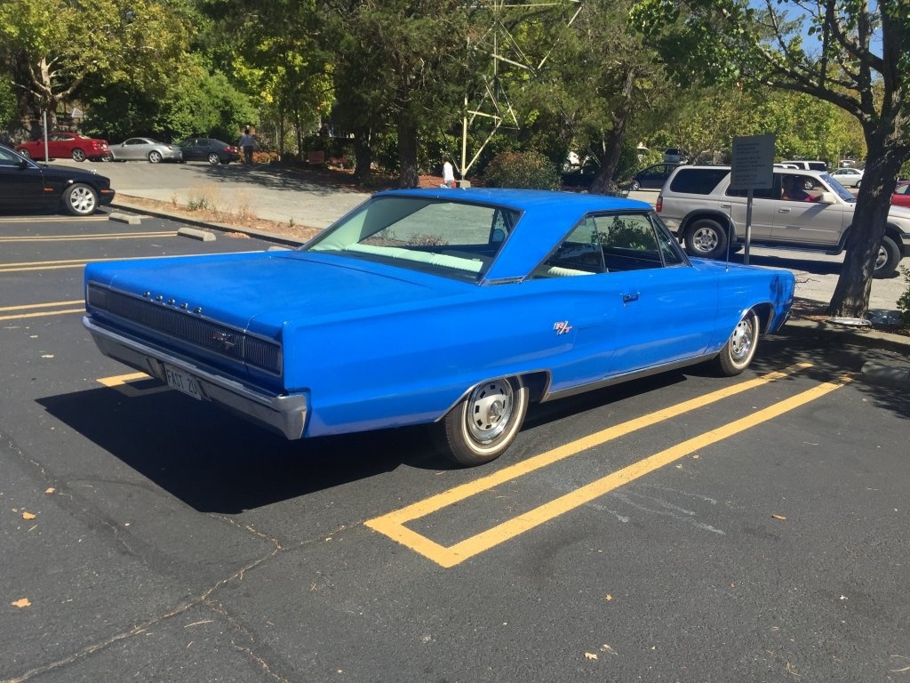

I am also thinking about 225/70r15 on my 67 Coronet RT. I have 15x6 4" BS. What did you end up using?
