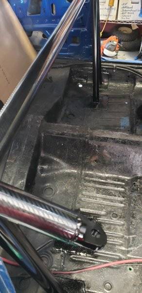

Might be a noob question but here goes, On the main hoop of your roll cage how did you weld the rear support bars to the top of the main hoop without burning up your headliner? I'm talking about two bars that go into the trunk over the backseat. Thanks.
Look at the 8th page. You'll see.

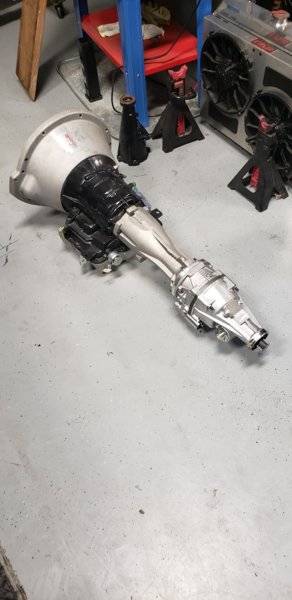

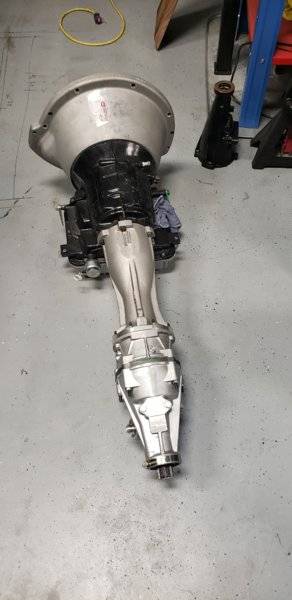

More pics to follow, anyone have a power glide with a gear vendors?

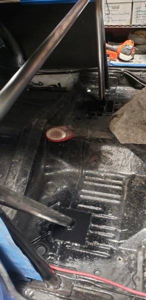

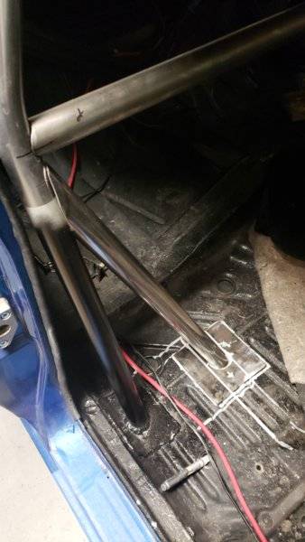

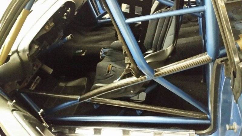

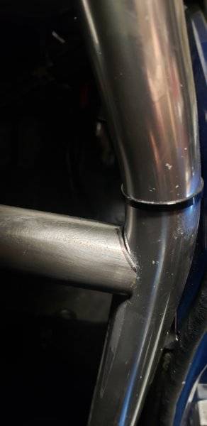

More roll cage work, all points welded in. Carpet cut, seat and seat bar mocked up. No notch cutter here just 2 cuts with a grinder flap wheel. Most of the time it fits great. Only took up till now to get the hang of it.

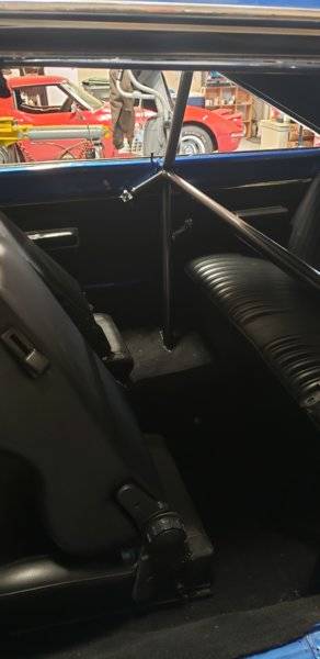

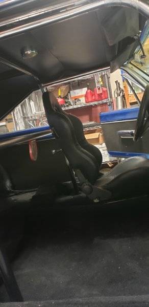

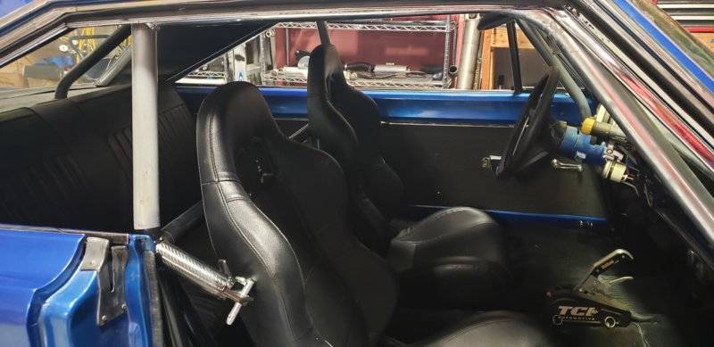

Back seat installed, front seats installed. My door bars are at the powder coaters.
Powerglide with bell, gear vendors overdrive. It's only 7 inches longer than a stock 727

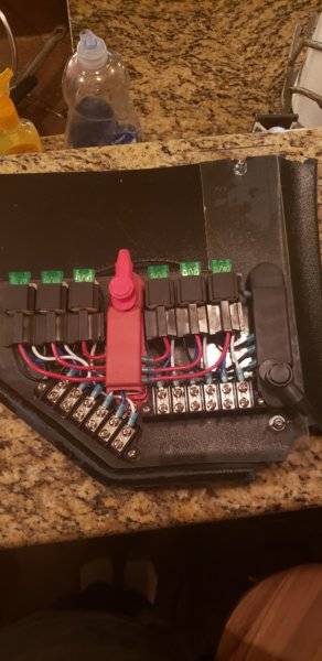

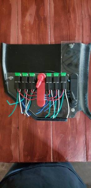

Relay board, wing nut mounted to passenger side kick panel. Have never used these type of relays with the fuses integrated so well shall see. I'll terminate the green wires 87a because not needed. The blue wires will go to a terminal block. The white wires will also go to a terminal block. I'll get them installed and post a final pic.
That's a clean setup you do some great work. Curious about the relays with fuses where did you find them.

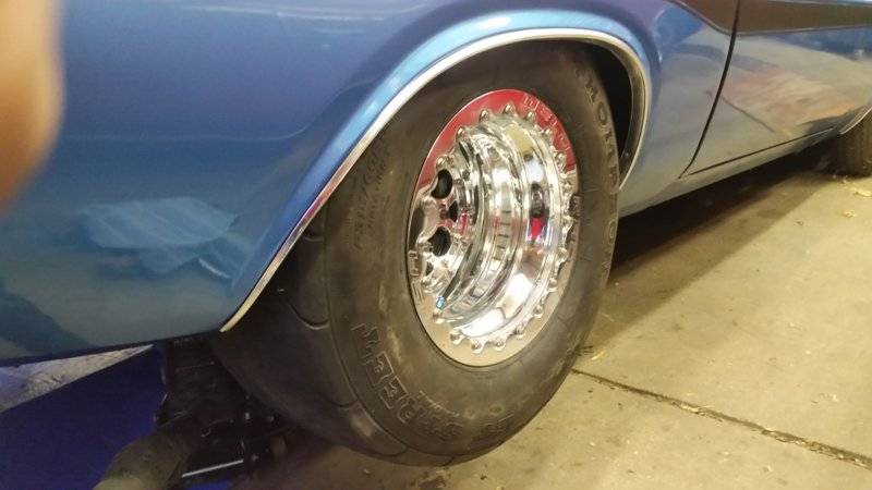

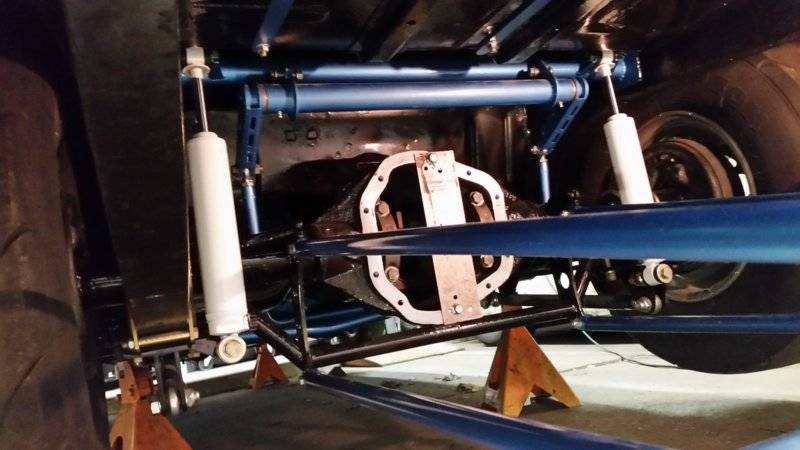

Looking good. Pretty much the same thing I have done on my Challenger. Mini tubbed, caltrac, split mono leafs, 25.5 caged though. I can fit a 315/60/15 D.R. or 29.5x10.5W with room to spare.
