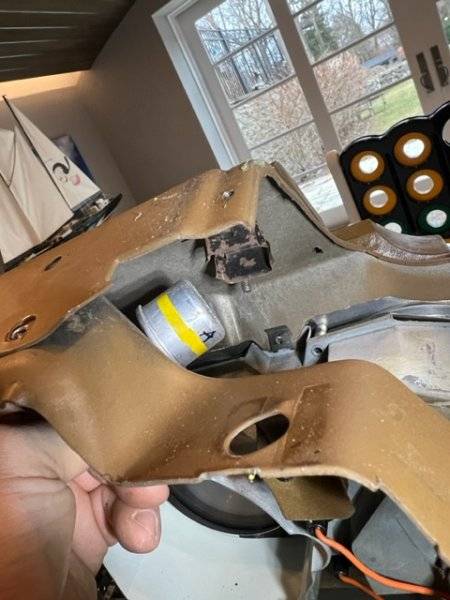

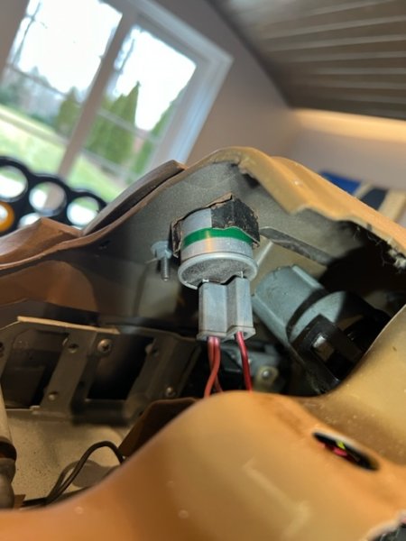

My hazard lights not working. The turn signal indicators do work but they are so slow in blinking. I purchased new flasher and it didnt do anything. Do the hazards work on the flasher as well?
There are two flashers on either side of the steering column. Both are silver. One has a yellow strip and one has a green strip. Any help or check would be appre
ciated.
Why are they two flashers anyway. I know one does the turn signals
Thanks
The other one does the hazards. You can check for power at the flasher plug with your voltmeter, one side will have power of course when the switch is on. I find that my switch seems to get dirty contacts if I don't use them for a while. A few times switching them on-off-on usually clears it up.
With the dash out of the car, you'll need to have a good ground circuit for everything back to the dash, as you probably know.

As long As I know one flasher is for signal turners and the other is for flashers I will chekc them out
I put in new over the counter flashers and the signal lights work faster and the flasher is louder
I replaced the opther flasher and the same thing. Nothing works. So it may not be the flasher Im thinking
