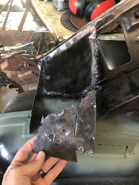

Attempting to make the lip of my package tray. Not pretty but also not seen. Thoughts?

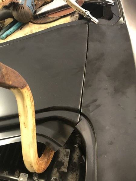

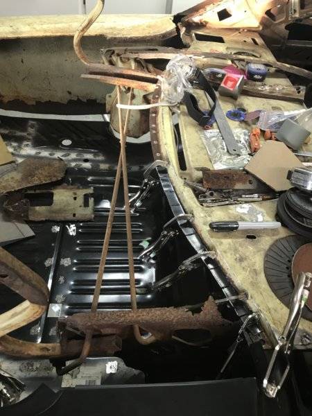

Another test fit of the quarter panel with the new package tray extension and lower back window piece. I will get to test fitting the new Dutchman panel with the new passenger quarter and the original drivers.

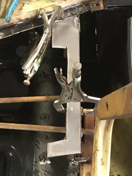

Attempting to fix this upper trunk support/deck lid support. I wish they made as many parts for a Coronet as they do a Charger. Oh well, this will work for now. Maybe in a few years AMD will make these parts.

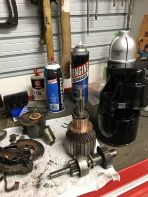

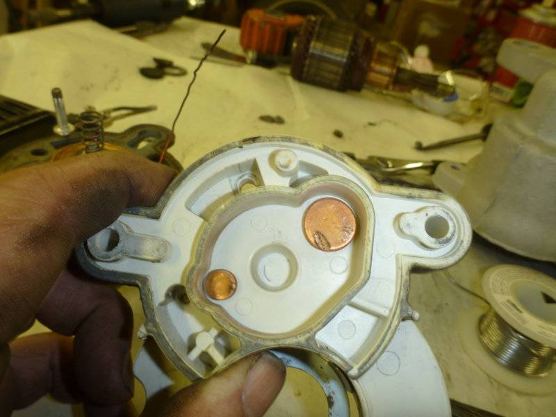

Working on the starter. Is this normal wear? and if so, should I replace any of these copper parts?
Normal to a point from cranking with a low battery in most cases, or a sticking/ dragging solenoid spool and arcing due to week contacting. As "kids" we'd crank the cable stud as hard as we could to get a new fresh spot so our cars would start.
Oh.. and yes you either need to clean them up smooth or replace them. Yours don't look far away from a no start..
This is more what I would call normal for a quick clean up and reuse..

Thank you dadsbee. I’ll clean these up. I looked online for the starter cable bolt but didn’t see anything. Do you know if these are available aftermarket?

Starter is coming along. I was reading about the finishing on the starter and it said to use 30° gloss black. I’m not sure what that is exactly but I did use gloss black and the nose is aluminum.
