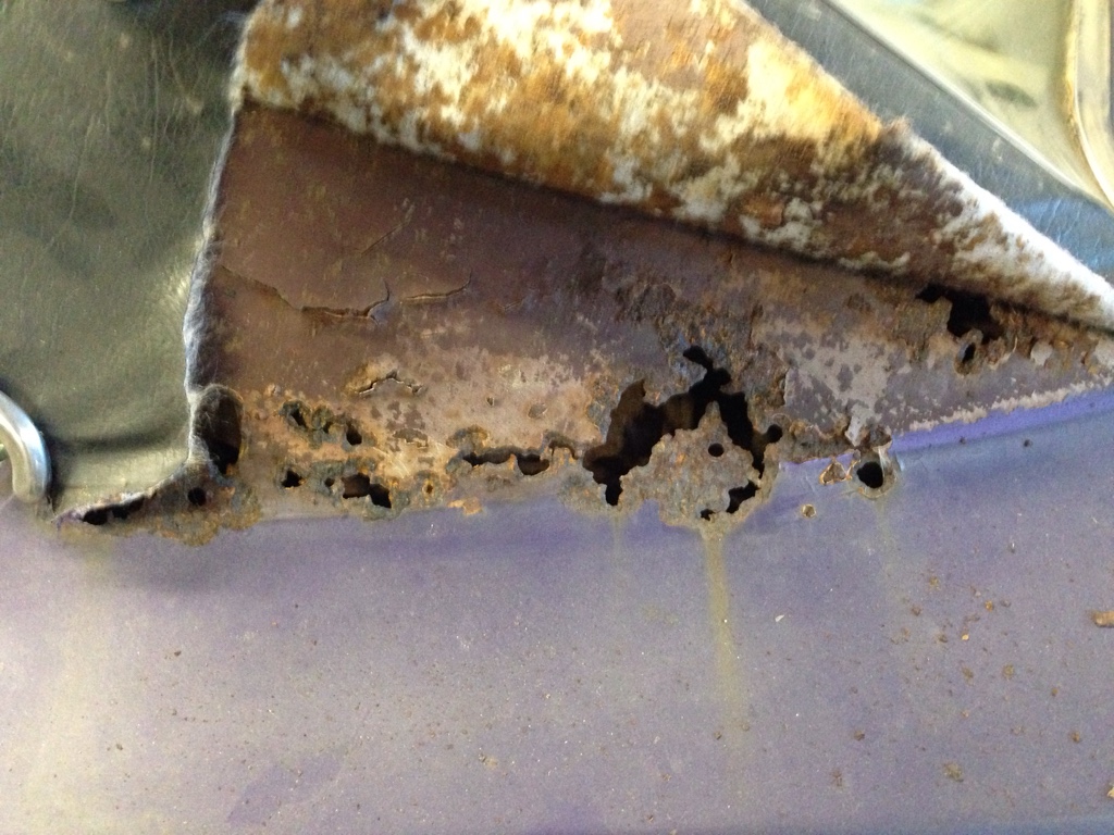

The next step will be addressing the rust. It's a fairly solid car besides the trunk pans and under the top. I plan to put a roof skin, trunk pans and both rear quarters on it from AMD. I will be going back with the Purple as well.

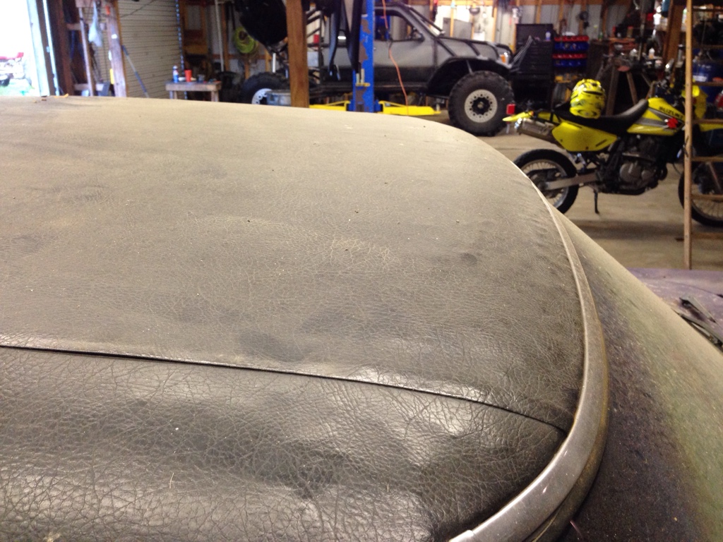

Nice car! That's where I was when I started with my 70 RR project. I had a good intact interior, basket case engine, and rust. I got it running first to keep me motivated and started to address rust. Mine was easier as the rust was in the lower quarters and rockers, that vinyl top has destroyed ur roof and its spreading into the quarters.

I'd like to keep it a vinyl top after I skin it, but I'll actually paint it underneath.

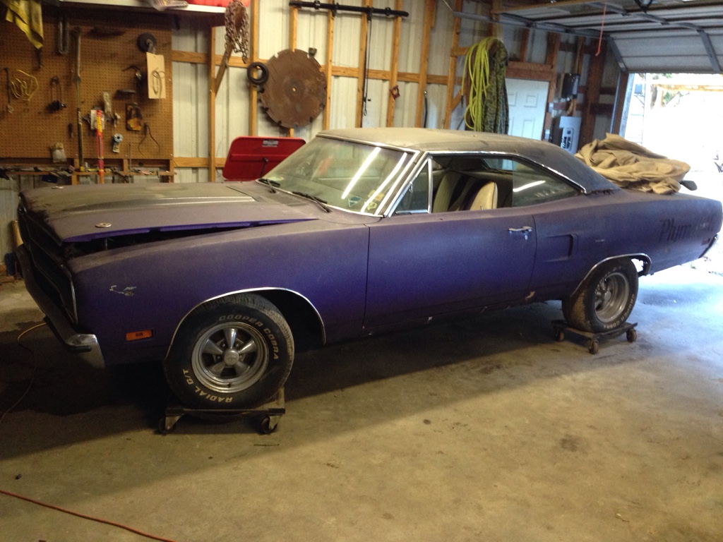

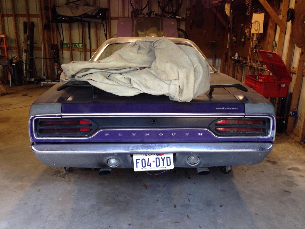

Looks like a pretty good base to start on, good thing you kept it all those years ago. I like the extra trim around the tail and wheel wells that you usually see on a GTX.
Nice project. It looks like you'd better buy the roof that's been advertised on here lately.
Yea, I'm not sure what is factory or what has been added on over the years. It has power steering and a/c, but manual drum brakes. I have disc to put on the front though.
Which one is that? I should mention that I have a decent background in fabrication, as well as the tools to do so.
Yea, the drive from Texas to PA may kill the deal. lol. I plan to buy a new skin.
