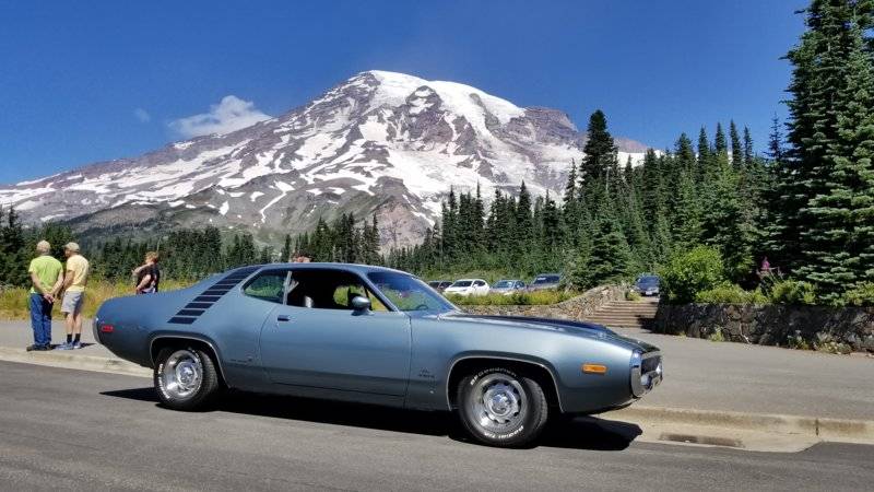

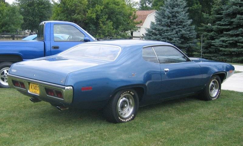

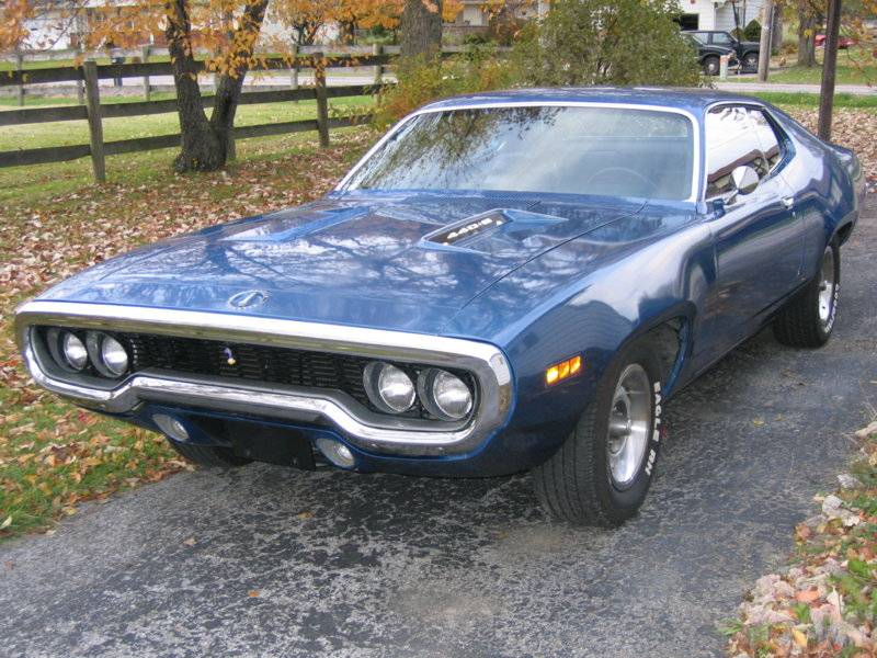

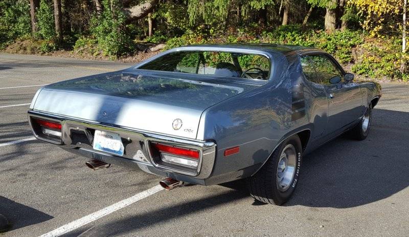

Thanks 72roadrunnerGTX, that's exactly what I'm looking for and even the right brand tire. Is there any way I could get a couple pics from the rear. I'd like to see how wide the tire looks from the back.
Thanks again. Damn I love your car.
It's kinda hard to tell at that angle but it gives me a pretty good idea. The 255/60-15 has tue same specs as the Goodyear polyglass g60 so I guess it's original in size. I think I'm getting to picky on this lol.
I like the pic of the snow covered mountain in the background! Kinda glad there's no mountains where I live because they make me want to 'explore' them!
I agree about that pic, It's nice. Someone should do some editing on it and remove the people and the cars in the far parking lot. It could be poster material.
Some background, had to wait quite awhile to get that shot, very crowded parking lot at Paradise, WA. Located at 5400 feet (tree line), in the Mount Rainier National Park. Best part was the drive up and back, second clip, except for some lane closures that day. Part of an organized cruise with the local Walter P. Chrysler club a couple of summers ago.
