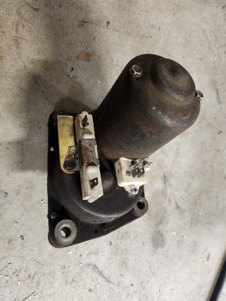

It will have to be 71 or newer due to the fact your wipers are hidden/off glass when parked and 70 on back are on glass park.
I went through this on my 71 RR a couple of years ago. There's some conflicting info out there, but from what I found (after getting a few motors from a few different cars), the 71 is pretty specific to that year. 72 uses a different shaft size where the linkage attaches. The good news is that it's not difficult to take the shaft from a non-working 71 motor and put it in a 72, which is what I did.
I *might* have a spare setup for a '71 on my shelf... I vaguely remember assembling a second one as a spare.
Let me know please.
Yep, I did put together a spare. I didn't clean and paint the outside, but I disassembled, cleaned and greased all the internals. The internal parking cam on these gets gummed up with hardened grease. Shoot me a message if you think it's what you need.
