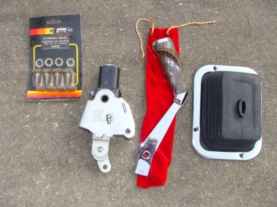

Here are a few pictures of some parts I have that will work in the RR. I rebuilt the shifter mechanism about 2 years ago. You can still get the parts for them. The shifter I have is actually for a 1970 E-body Challenger / 'Cuda and it has a push in style shifter handle. In 71 Chrysler changed the design and went to what we now see all the time..... 2 bolts that hold the handle in position.
I may end up keeping the shifter for my 70 Challenger, and start looking for a later model one.

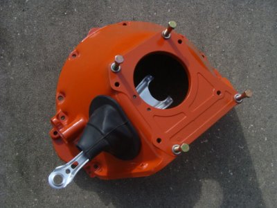

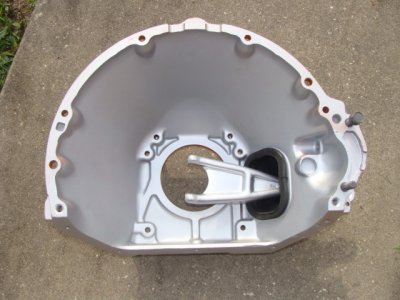

The bell housing I picked up a few years ago at the swap meet show "Mopars with Big Daddy" near Ocala, FL. I cleaned / degreased it then glass beaded it and checked all of the thread holes. After that I sprayed it with cast aluminum. The final touch was the Chrysler Hemi Orange.
I recently purchased a new clutch fork for the Challenger. I will have to check it against this one to make sure it's the right length.

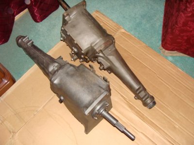

Finally, the 2 four speeds pictured are freshly rebuilt 23 spline units. They have the dual bolt pattern for both "B" and "E" body cars.
I replaced all of the synchronizers, snap rings, seals, bearings and set the end play. Then I get new shifter forks from a later model transmission and use them. The late model forks are steel, where the earlier ones were brass. You have to modify them so they will work, by machining down the small protrusion on the end so that they will fit inside the side case.
I always use the steel forks now because they are a lot harder to break when you're slamming gears ....... Don't ask how I found that out...... :angryfire: All I'll say is that it sucked having to limp the car home in 3rd.... Luckily I had a set of 4.30's in the rear !!!!

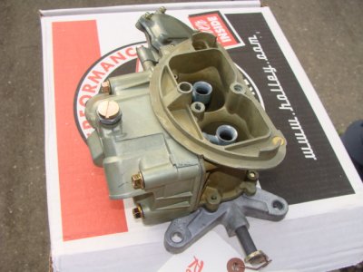

These pictures are of the new carbs that Holley offers, along with some engine parts for the RR. The new carbs look like the originals with the exception of the fuel bowl screws. The new ones don't have the flat screw driver head like the originals did. I purchased a set of replacement screws to make them "look" original.

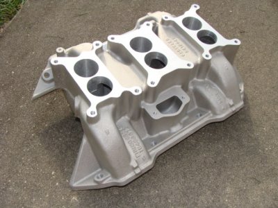

The intake is a new Edelbrock offering. Once it's sitting on top of the 440 source heads I will paint everything Hemi Orange. No one will know the difference because I may end up grinding of the Edelbrock name.

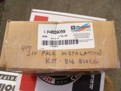

Chrysler offers a six pack installation kit that has the coil bracket, fuel lines, throttle cable and bracket, return springs and throttle linkage all in one box.
It is part #P4529059 and has everything you need. They are available for both small and big block applications.

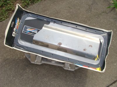

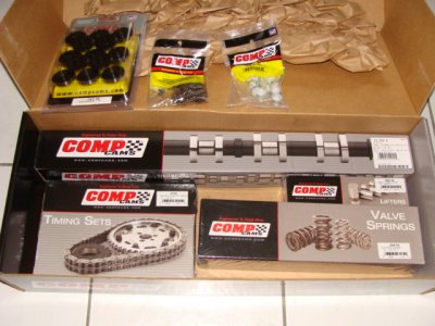

Then I have a windage tray and an "Old School" 292 Comp Cams cam kit. It comes complete with Timing Chain, Valve Stem Seals, Retainers and Locks, Valve Springs, Lifters and Cam. The beauty of this kit is that everything is perfectly matched to work together. You don't have to worry about coil bind and seat pressures, etc.
.501 lift, 292 degrees and 110 center line. I know there are a lot of cams out there, and that the mopar cams have wider lobes, but I've used this set up before and it works. I'm not building a rocket ship, but I want the car to have a nice choppy sound at idle and still make respectable power.

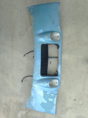

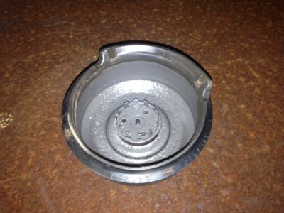

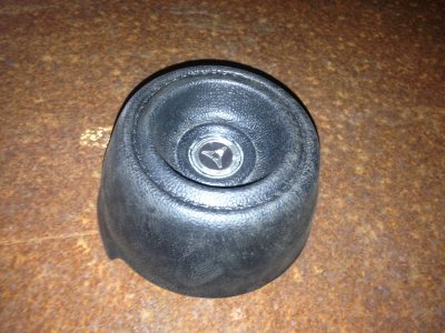

Here is a part that I located for the RR a few days ago. My car was missing this part. I glass beaded the back side then clear coated it to keep it from rusting away. I only gave the black part a quick wipe down for now. It will get nicely detailed later in the restoration. Right now my mission is to try and preserve the car from any further deterioration, along with locating missing parts.
Look close and you can see the very rare driver side floor freeway ventilation system....... You can use the torsion bar as a foot rest too...... Works great for those with a heavy right foot.:laughing1:
The part fit perfectly and came off a Dodge. I plan on getting a new RR center emblem for it later.

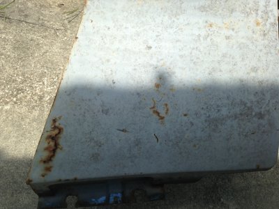

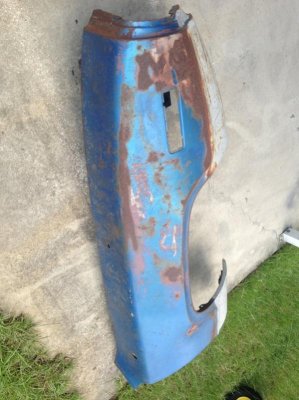

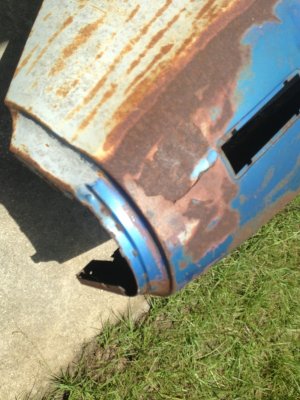

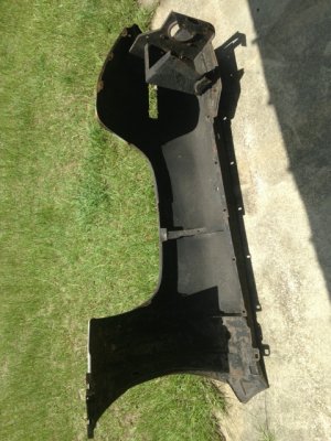

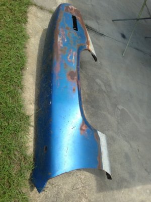

I was lucky and found a decent fender locally for the RR. This one has a small bit of rust at the lower bottom corner where they all rust at. You can see the rusted area in the second picture. AMD makes a patch panel for this spot. Once the fender has been blasted I will know if I need the patch or not.
The area of the fender that is in between the front side marker light, and bumper area has a small dent. It was previously repaired and you can see this old repair in the 3rd picture. I will work this area out using a stud welder until it takes only a small amount of filler. Pictures will be taken and posted along the way showing the process.....
Overall this is a very useable part. (and it's a lot better than the one on the car now ..... )

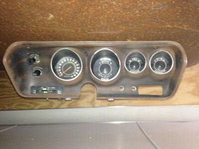

These pictures show the new replacement dash bezel with the original gauges. The last 3 show the SWEET front lower valance that I scored from a fellow FBBO member. It's original and straight as an arrow. I has been repainted once, but I'm taking it down to bare metal.

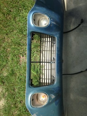

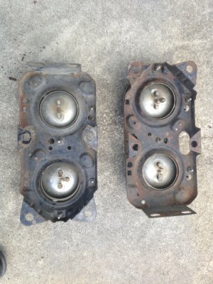

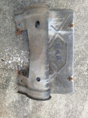

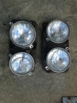

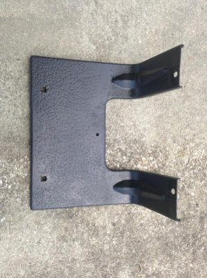

This last set of photos show the rear fold down license plate bracket, front head light buckets, and front license plate bracket. My car was missing the rear license bracket, and luckily I found one on EBay that was pretty nice... It's in pretty good shape, so I'll set it aside for now.

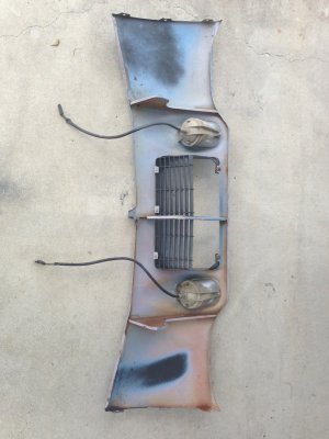

Next you see the head light buckets. The originals on my car have some rust on them and these are better than what I have. Soon I'll post a little before and after shots with the buckets showing how I restore them.

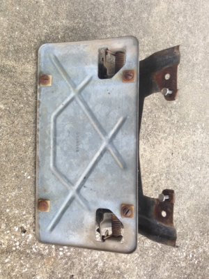

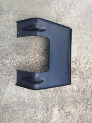

The last 2 pictures show the front license plate bracket. I found this part lying inside the trunk of the car after I brought it home. It was pretty badly surface rusted. I sand blasted it and them painted it black to preserve it for now. If you look close you can see the rust pit marks. I can fill those in and the part will look brand new when it's done. The rust has been killed, and the metal is still intact.

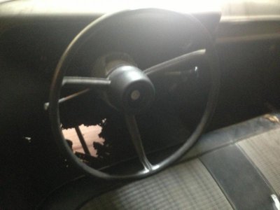

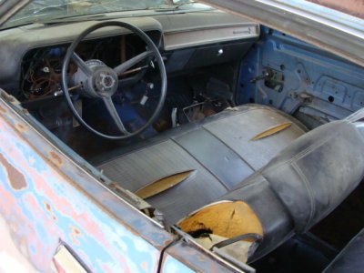

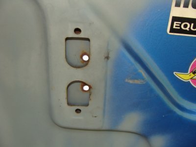

These two pictures show the original bench seat and the condition of the dash. Previously I had removed the door panels to gain access to the door internal parts. I tried to get the windows to roll up and down a little better, and I wanted to see how bad these original doors were. The passenger side door had a pretty nasty dent, but luckily I was able to pop most of it out. The dent was about 6 inches deep.

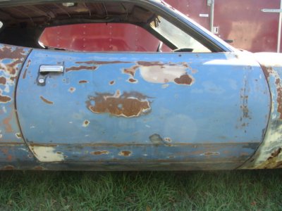

I still plan on using the doors from the SSB parts car. They are much better. These original doors are useable with some work. But I want to make her as nice as possible.DSC03500.JPGIMG_3658.jpg
The last photo shows the door prior to working on the dent. The second to last shows the end result.

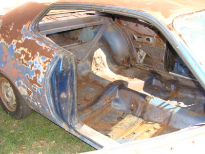

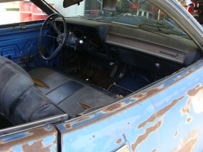

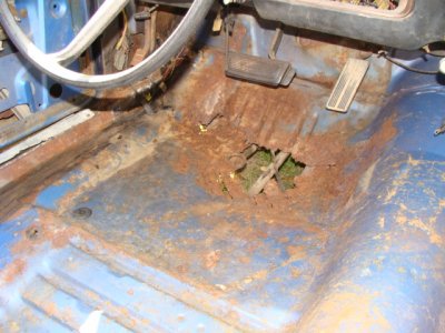

DSC03477.JPGDSC03478.JPGHere are a few more pictures that show the interior of the car after the carpet and seats were removed. These pictures were taken around the end of May. I have been too sick to work on anything. I didn't want to let the thread slip away, and I wanted to keep you all posted with progress, even if it's a little old. These photos show the condition of the floor pan. As you can see there is a large hole where the driver would rest their feet. The passenger side looks to be fairly intact, but the truth will come out after blasting.

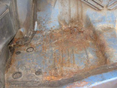

This set of pictures show what the rear floor pan condition is like. Remarkably solid, but again, it has not been blasted yet. The floors in my Duster looked similar to this, but ended up having a few small pin holes after everything was cleaned and blasted.

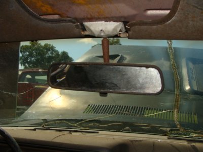

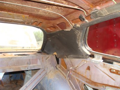

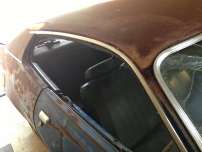

Here are a few pictures showing the condition of the inner roof structure. Again, these photos were taken around the end of May.DSC03476.JPGDSC03481.JPGDSC03482.JPG I left the sail panels in place and re-installed the head liner bows after removing the fabric and jute backing from the car.
If you ever decide to try and replace the head liner in your car it's not all that hard to do. One very important thing to keep in mind is this:
Always keep the bows in correct order. Number them or tag them as you take them out, so they can be reinstalled in the same position later. You will not be very happy when it comes time to install your headliner if you don't. Very Important.

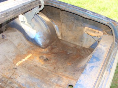

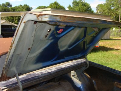

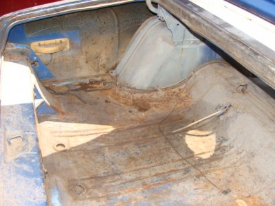

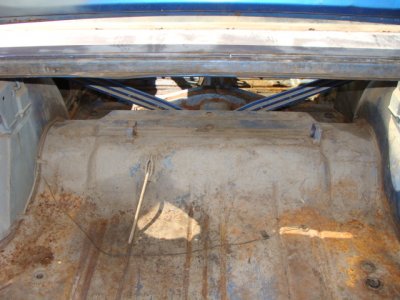

These few photos that were taken at the end of May, show the condition of the trunk floor after everything was removed and it was vacuumed out. I am very happy with what we found. So far the car is starting to look even better than I originally expected. I don't want to get my hopes up too quickly though. The final truth will show after it has been blasted.
I hope I start feeling better soon so that I can get back out in the shop. The trunk lid has some rust along the lower edge. It can be fixed, but I will probably end up using the one from the 72 SSB instead. It is rust free and only has a very small crease to contend with.
I will cut out the openings for the "Go-Wing" spoiler that will be installed on the car later. These pictures show the original openings that I can use as a template.
