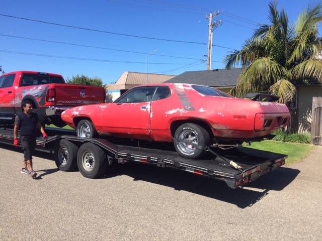

Today I took delivery of my 71 Satty clone. She is wonderful ! Full of history, life, and patina out the *** ! :)
(how fitting she arrived with a new Power Wagon leading the way !)
Found the car on CL a couple weeks ago in WI. I'm in CA. and would have driven her home if the owner didn't advise against it. LOL .... Struck the deal, and patiently awaited delivery.

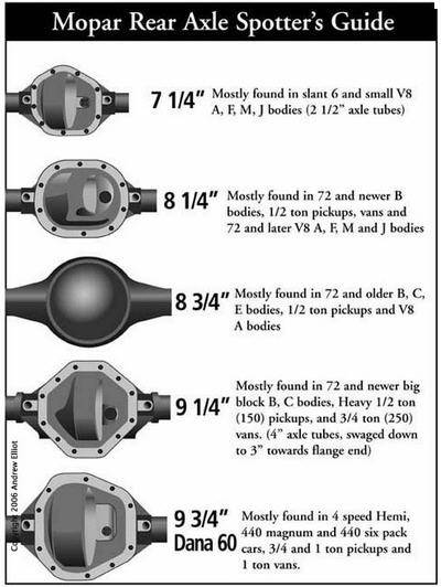

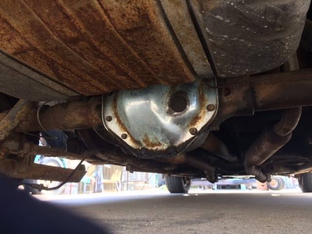

It clearly has a non correct rear axle, but from what i can see, is probably leaps and bounds better than the stock 7.75 it would have started life with. I haven't researched this yet, but i'd guess this to be a Chrysler Dana axle ? Maybe a 9.25 ? What are your opinions on that ?

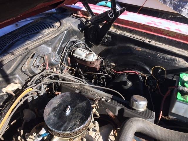

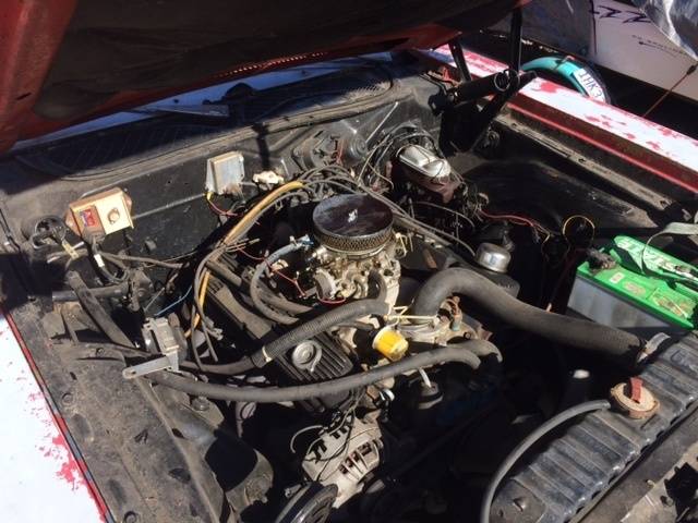

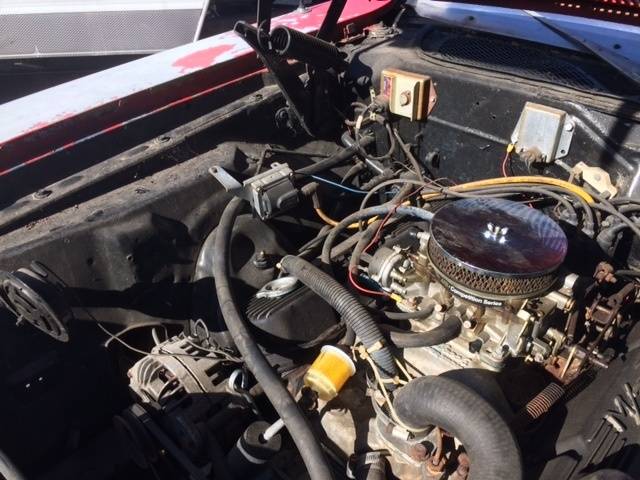

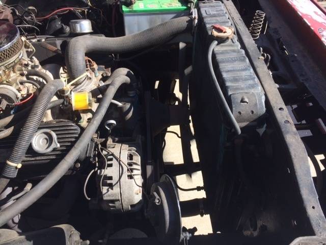

Here are some underhood shots, feel free to let me know what you see to be incorrect as i'd like to get the engine bay as it should be. I popped the dist. cap off, and it has an electronic dist. Should have been points i would imagine aye ?

some help with the diff id

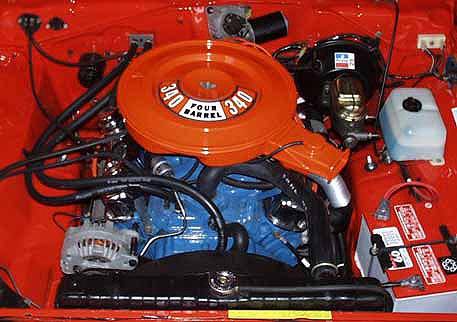

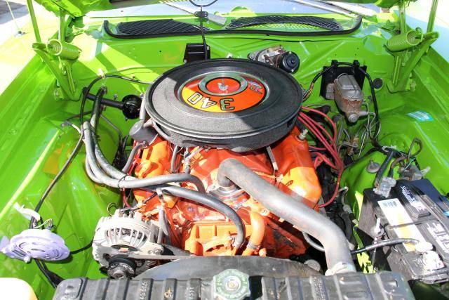

Question 1: I feel that ridiculous, tiny air cleaner is too small, plus it looks dumb. I'd like to put the proper 340 style air cleaner housing on. Will it fit this aftermarket AFB ? and will it clear the hood with the Edelbrock intake ? (It is not the Air Gap manifold)
Anyone have a pic of the correct '71 RR air cleaner housing ?
Thanks Poly, looks like i was right. 9.25" it is. I would assume this is plenty beefy for a built 318 and maybe more ? Hope it's a posi !

look like a 9.25 to me to ,plenty beefy :thumbsup: ist pic might be an a body I think but was in my 340 reference pics

Believe it or not, that is how i want the engine compartment to look on this car. I'd love to pop the hood and shock the **** outta someone when they see it. LOL I know, i'm twisted. ;)
So what is the difference between those two air cleaners. I see one has a snorkle.

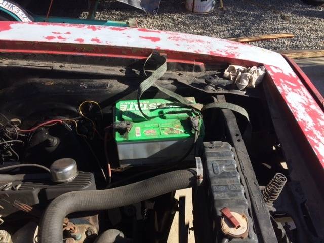

Took the maiden voyage today... drove her about 26 miles round trip to the DMV to get it registered. Was running warm the whole way... got up to about 210* for a few minutes at one point. Will have to look into that. Hopefully some jackhole has left the thermostat out thinking he was "helping" I'll look into that tonite.
