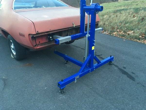

Started to reorganize the garage so I can set up a new rotisserie just bought.

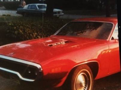

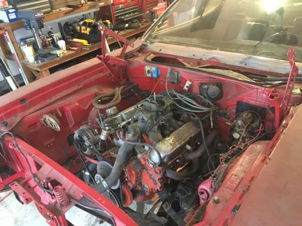

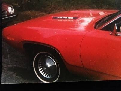

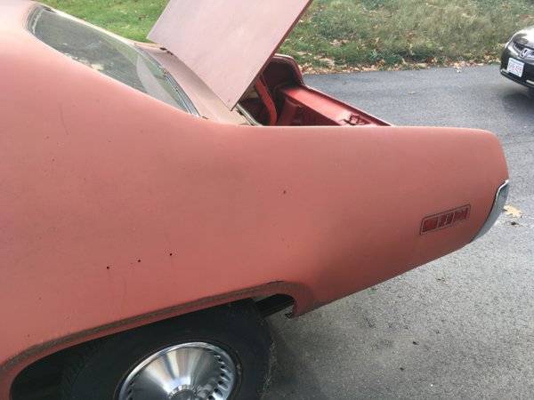

Thought i would show the 1980 photos and some from today, pre-teardown.

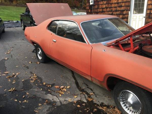

From today - out of the garage and uncovered

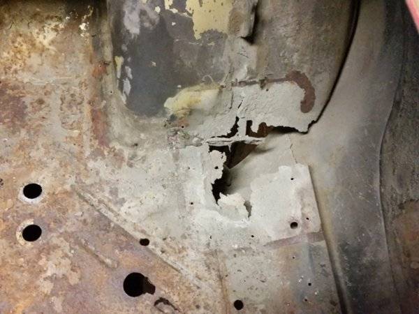

Pulled the mat.... mouse crap, dirty but very solid

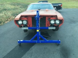

I'm doing the body and paint myself. Getting the garage prepared for the tear down and sizing up the rotisserie on the car. I should be dropping out the drive train this week end coming up.

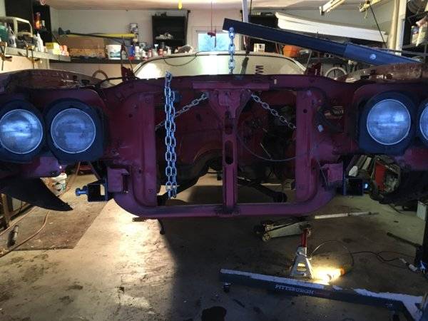

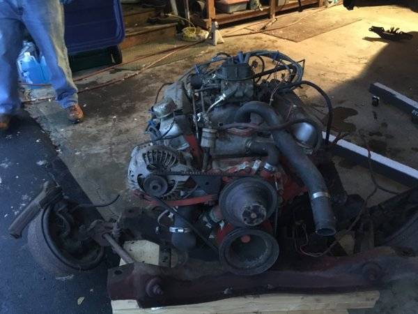

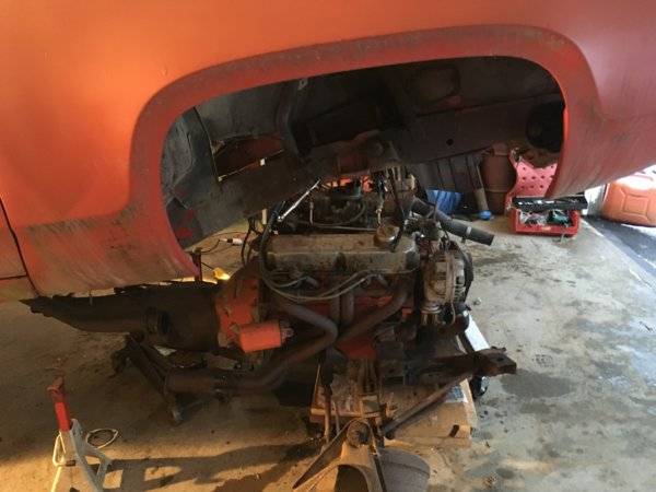

Dropped the drive train out last week end. It went pretty smooth with exception that the last 2 bolts.... of course the last 2 bolts would not break free on the K-frame.
Extreme heat did not help but leverage did break the heads off the bolts.
Here are some pics of the progress.

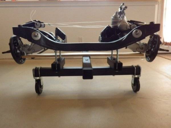

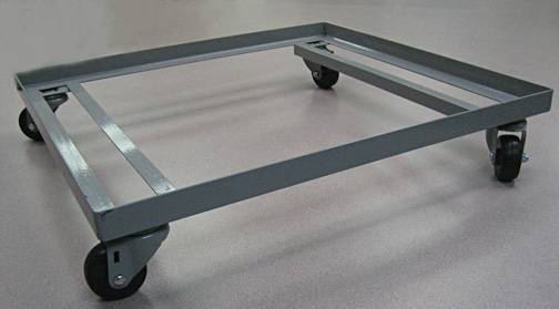

Thank you for sharing these pictures, its looking great! What did you use for castors to move the engine on the ground? I am soon to put mine back in early next year and want to go under the car like you did. With the k frame on, how much room did you have for the oil pan?
I happened to have an old bread factory tray steel dolly laying around like the pic below.
I put 2 - 2x12x26inch planks inside the frame so the k-frame could rest on it. My wheels were steel though and the dolly had a capacity stamp of 1500 pounds.
My oil pan does not go below the k-frame member so no issue there.
For the A833 4sp attached to the engine.... I had a HF furniture dolly which worked fine for the trans to rest on.
Later on, I'm going to fabricate a very low profile steel tube dolly like in the attached pic below.
Nice 71! Looks solid. I like the way you dropped the engine from under the car. I have a 72 Roadrunner and am planning to install the engine tranny and K Member in the same fasion. I am also in New England. Keep up the good work!

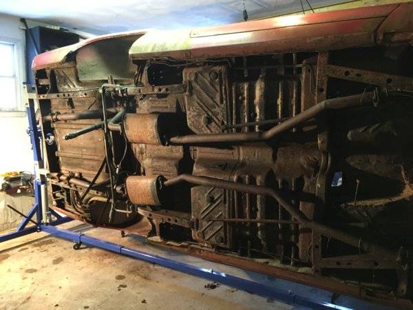

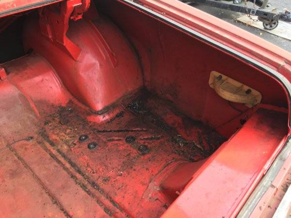

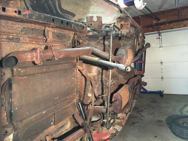

Finally dropped out the rear suspension and gas tank etc....have the car on the rotisserie.
I'm extremely happy to still see a lot of the undercarriage still shows the galvanized metal where Plymouth dipped it.
