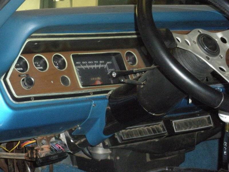

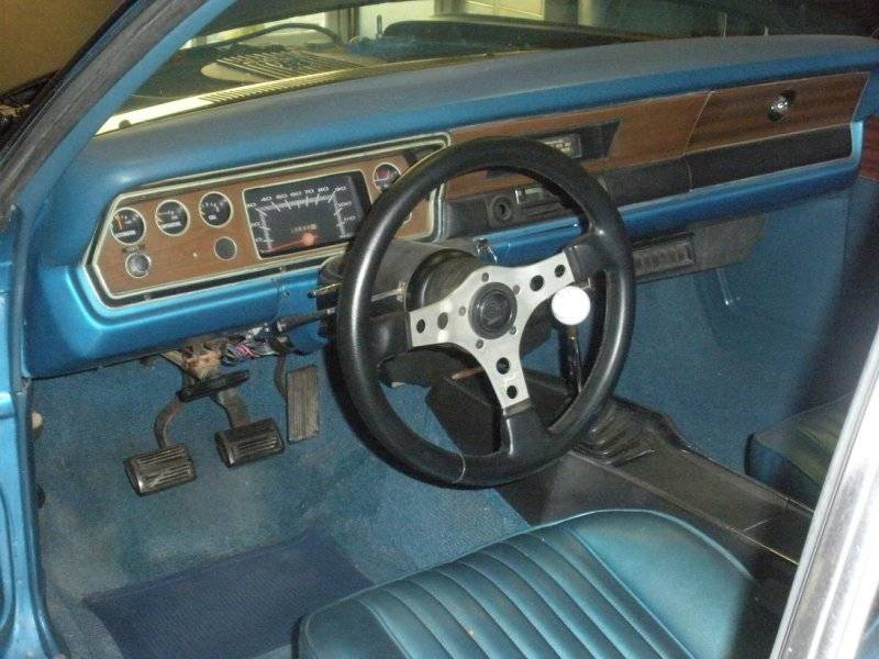

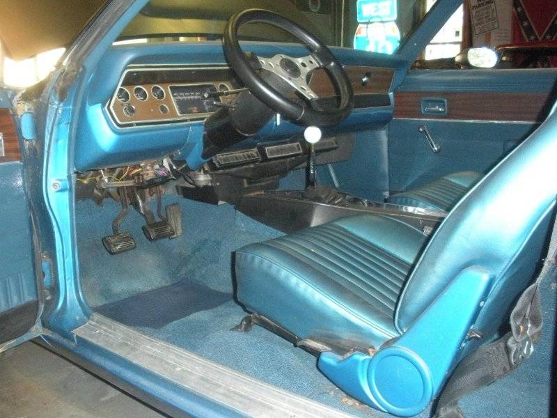

I did this to my 74 Duster in 2009.
The column fit fine but was not a-direct bolt in. I had to modify the wiring. The mounting brackets needed to be adapted to fit and the bolt in shaft with the coupler had to be shortened. These columns use a combination of Mopar and GM parts. They use a rag joint up near the firewall and a regular Mopar pot coupler.
When it was done, the adjustment range was amazing. In the Duster, the steering wheel did sit closer to the driver than before so a wheel with less dish would be a good choice. I am going to do this swap in my 70 Charger…. Maybe over the winter.
The column worked out okay.

If you are contemplating this swap. GET all the wiring from the column down to the plastic quick connect plugs and beyond. It will simplify matters.
The wiring is also a hybrid of GM and Mopar parts.
