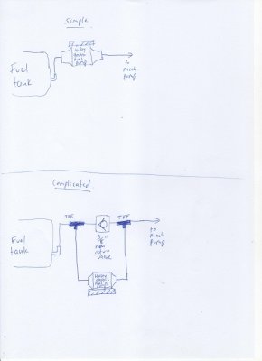

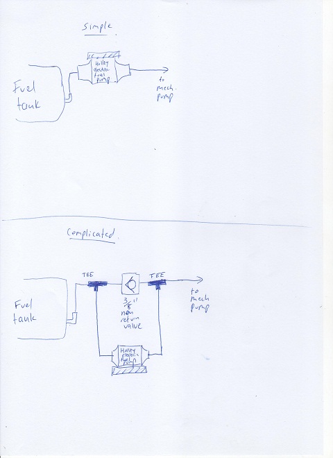

Hi Guys. I've seen a few threads where some have thrown this idea around, but I have not found definitive results or conclusions, so I'm asking for educated thoughts or experiences.
I usually only drive my car every few weeks, and when I go to fire it up, the carb bowls are absolutely bone dry. The mechanical pump takes an age to fill the carbs and the poor starter gets a hammering before the engine finally fires. (Having dual quads I imagine makes things worse compared to a single carb as I have 2 carb bowls to fill up ...)
So, I have bought one of these Holley Elec pumps to install by the fuel tank in order to prime/fill the carbs before cranking -
My plan is to only energize this pump prior to cranking for long enough to prime the whole fuel system so the engine starts instantly.
As usual, I have been perhaps over-thinking it all and have concluded there are 2 different plumbing options to fit it. A simple way and a more complicated way -
I'm sure the simple way would work, but is it possible that at full throttle, the de-energised elec pump could restrict flow on the suction side of the stock mech pump enough to starve the carbs of fuel? (If so, that's why I thought the more complicated way with the elec pump in a TEE branch would minimise suction side restriction. The non-return valve is a necessary addition so the elec pump flow doesn't just recirculate when it's energised.)

I used to have a 440 with an AVS, that had the same problem. I did what you are proposing with great results. I installed a switch under dash, and would shut pump off after engine fired. I used the setup with check valve. It worked great.
your simple diagram is how I have it set up on mine.Same thing,,a switch to prime the carb and for spirited driving. A.K.A full throttle bursts but being completely legal........:happy7::happy7::happy7:
Cr8crshr has done 2 of them, on his Satellite and a 66-300. I have one on my van and need to install another on my 300. Yes they do work great for priming after sitting, KISS don't over think this! Don't make more work for yourself if not needed!

Thanks Bro for the lead. The only thing I would change on your simple version is to place the priming pump closes to the fuel filter in the front rather than by the tank. I mounted mine to the frame rail and wired in a single throw toggle switch under the dash wired to a circuit bus I installed form my extra gauges. I turn it on while starting and then turn it off when it gets running. I also have a metering valve so as to not over prime the carb bowls. But it is a very simple addition that I wonder why it took so long to do it???cr8crshr/Tuck

So you mounted yours on the frame rail by the engine and plumbed it in before or after the stock pump? (I'm sure either will work, but I'd think before would be better.)
I just had a look at how much room I have to mount it on frame rail - it will fit well but drilling the holes will be tricky. Might need to remove stock pump to make room for drill.
What is the metering valve that prevents over priming your carbs? (My elec pump only supplies 4psi so I don't think I need it.)

I would do it with the timer and a WOT switch and the simple plumbing.. Every time you turn on the key, 15 seconds or so of fuel pump and then every time you do "Timed" acceleration runs!
Also, check with the manufacturer of any electric pump you are considering using. Most pumps are designed to PUSH fuel and therefore should be mounted close to the tank and below it.

I like the idea of the primer pump on a timer and I have the same concern as you regarding the restriction. You can easily install it the simple way and make a test run. If it doesn't pose an issue then clean up the installation and let it go. Otherwise you will need a check valve.
Speaking of which, what is the cracking pressure of that check valve? Seems to be designed for this purpose but it would be nice to know it won't cause a restriction by itself on the suction side. Perhaps install the check valve first (on the pressure side) and see if that cures/helps the issue? Then install on suction side to see if it also cures the issue without causing a restriction. In my experience it's the engine heat that dries out the carb and evidence to that would be strong gas smell in the garage after you shut it down. In that case you will need the primer. I guess your gas isn't carb friendly either, huh?
