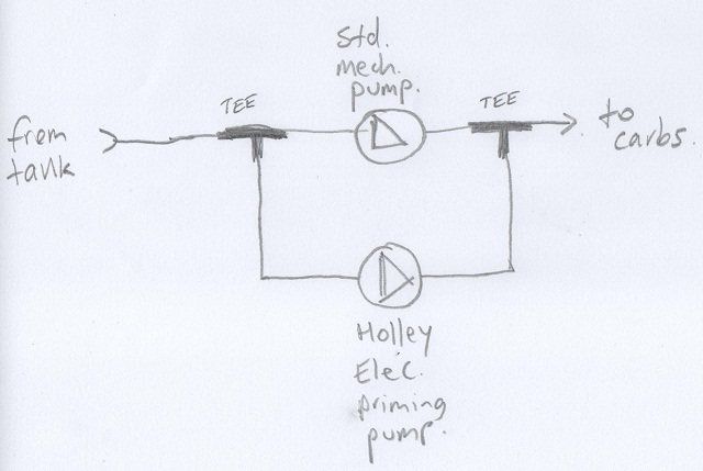

Since my OP, I am now considering mounting the priming pump on the frame rail in engine compartment, instead of by the fuel tank.
With this in mind, would it not make most sense to plumb the priming pump in parallel with the mechanical pump?
i.e. -
If you do that, wouldn't you need two one way valves as well..
Hey 62 Dart - I would suggest you find out how much restriction that Holley has when it's not energized. If none (or very little), would plumb the simple way. If not, then... I have a similar problem, but drive the car every few days so it doesn't come up.
I don't think so, as each pump has non-return valves inside them.

I've read that before, thanks Dave. More important if the electric was your one and only pump. I'm only using it to prime dry carbs.
