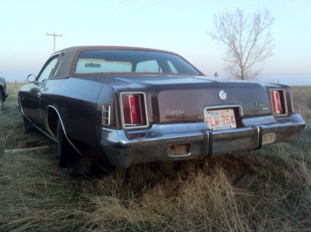

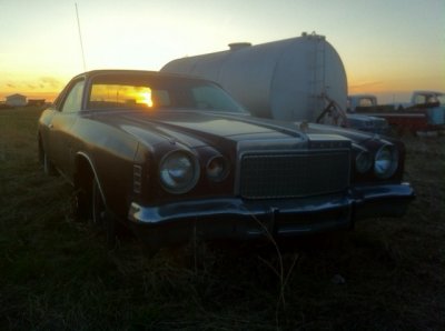

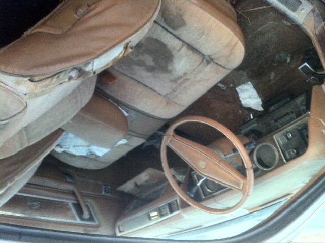

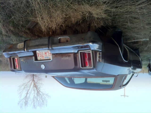

Anyway, forgot the good camera again, but here's a few shots I managed to take with the iPhone last night.

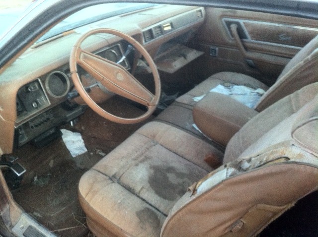

As you can see, the interior is about the worst part of the car. It's now sprayed down with a liberal dose of Spray Nine as it kills pretty much anything including the hanta virus. I just hope to hell it kills bubonic plague as well!

I have a couple reverse lights and lenses if you need them. I bet you cant wait to do a deep clean lol

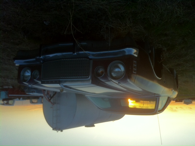

What the hell is with the upside down pictures, or am I the only one that can see them? I'm just not having any luck with pictures and forums lately!
Anyway, I just might take you up on your offer super77. I've actually got the drivers side, but the bumper is rusting from the inside out and the mounting tabs rotted away. They're both pretty faded and will probably crumble if I try to polish them out, but I'll let you know. Going to go look for a replacement bumper this weekend along with a trunk lid.
my guess is your iphone was upside down when you took em. you can edit them on your computer and save them right side up before you post to solve that problemo

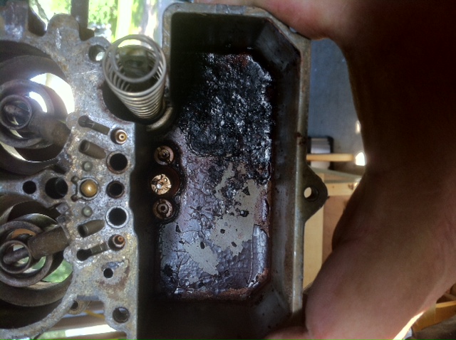

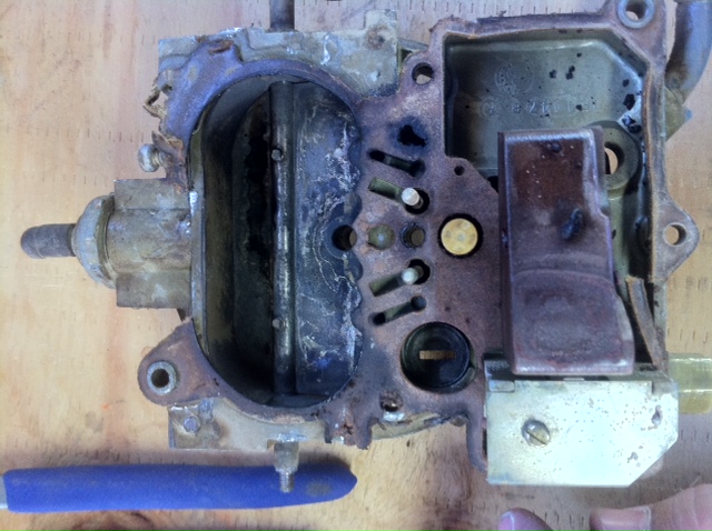

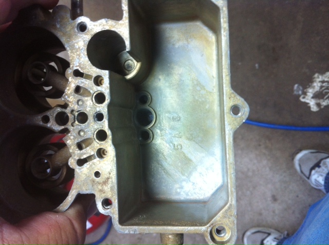

Call me crazy but I think I might have found the reason why I can't keep the car running.
And here's after a good soak.
