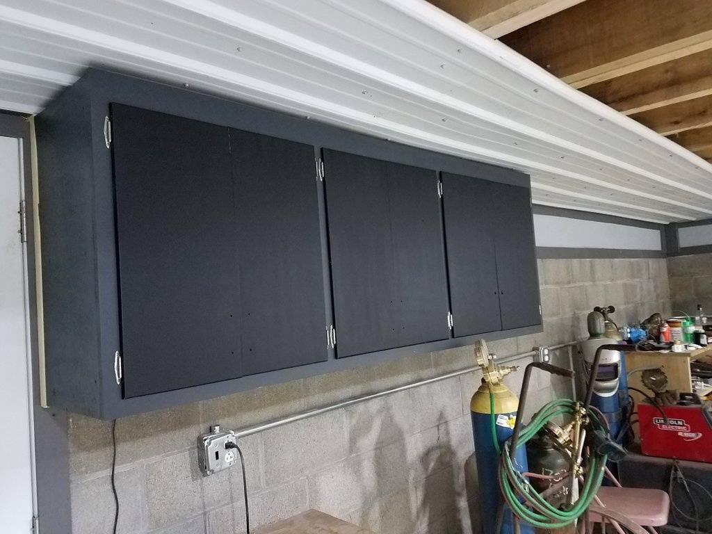

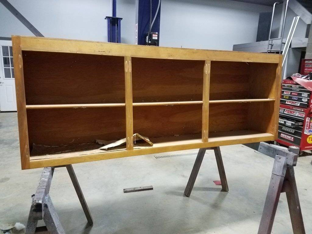

Cleaned up the hand me down cabinets, painted them and hung them.. perfect size. I wanted an area along that wall for welders, torches, etc and they fit right underneath perfectly. Also was able to shim it out enough to mount the stereo inside as well so it will stay clean now.

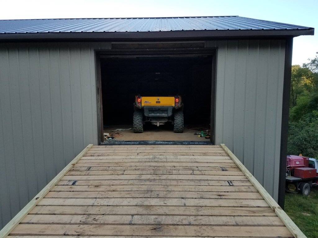

Finally, the bridge deck lumber has been sawed!!!! By the end of the weekend I should be in good shape:thumbsup:.
Flooring also arrived so everything is falling in place for my vacation from work to work even more!
Bridge at last!!!! Feels solid as a rock driving a 1,200 lbs Can Am across it so it's good to go. Need to build hand rails and fill in a small gap at the front but that's about it.

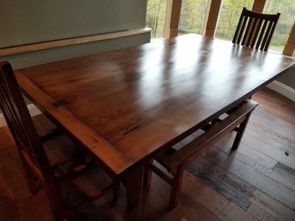

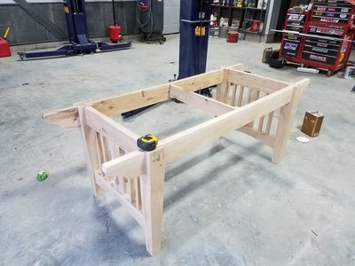

Moved onto the kitchen table with the chairs and benches done, the wife wanted an extra foot added to the width.... I was fortunate to salvage enough hickory from a rotted board to get it done. Should wrap it up in a few days.

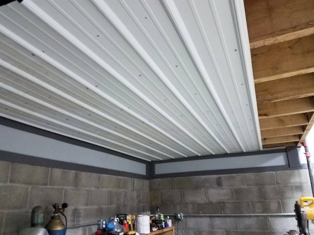

Also finished hanging the white tin on the bottom of the loft for easy cleaning and a bright work area. Started running conduit for lighting as well, likely T8s.... T5s I think would be to bright and I already have a couple fixtures that might get the LED bulbs.

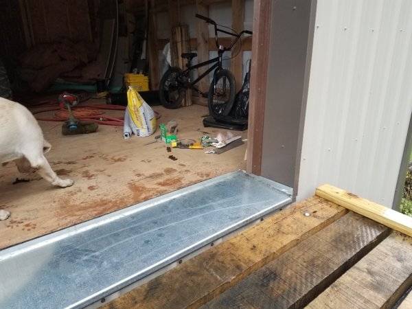

Finally inching away from the honey do list and managed to deal with the upstairs garage door. So here's the fix for rain getting on the outside lip and running into the upstairs under the door. I called a local steel supplier and had them bend 1/8" think galvanized steel to give me a 3/4" drip edge and a 3/4" inside lip with 1" of slope in the 14" depth then welded caps on the ends.... No more worries. For support I just cut a bunch of wedges out of treated lumber and slid them under every foot

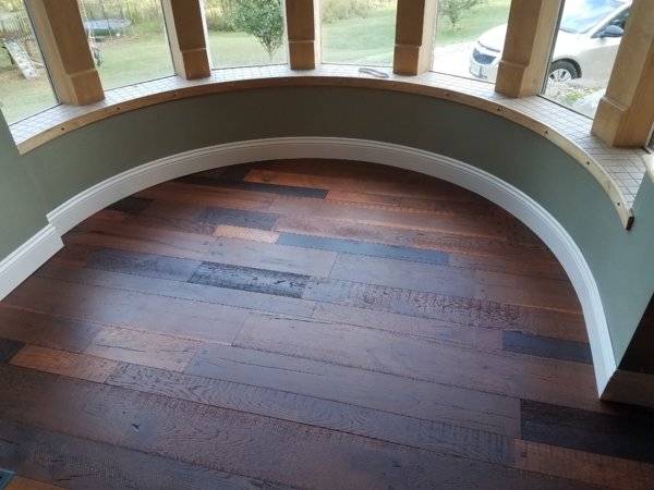

After 5 weeks I finally sat at my kitchen table again ahhh... Finally my place of relaxation is becoming a home again:thumbsup:.
Can't express how much I love this floor too, way more colorful and full of character than that nasty red oak floor we had, home looks completely different now.

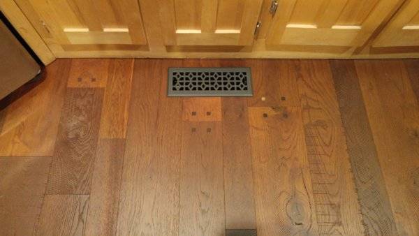

These 2 pictures show the detail a bit better. Oh yeah and she already covered a huge amount of it with a rug???:rolleyes: I really don't get it...
