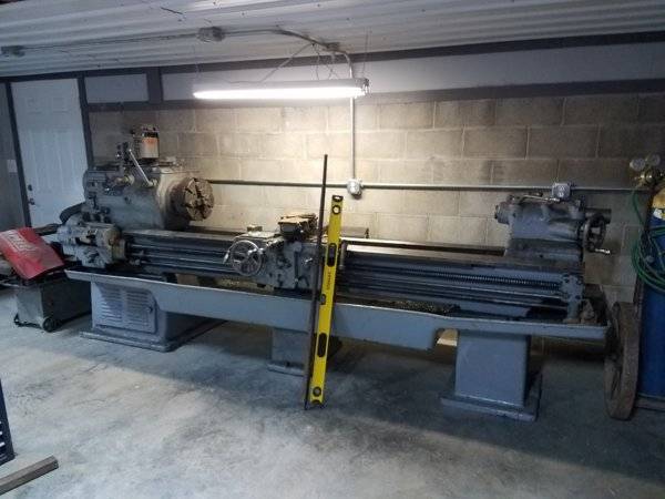

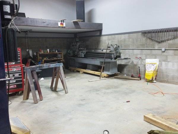

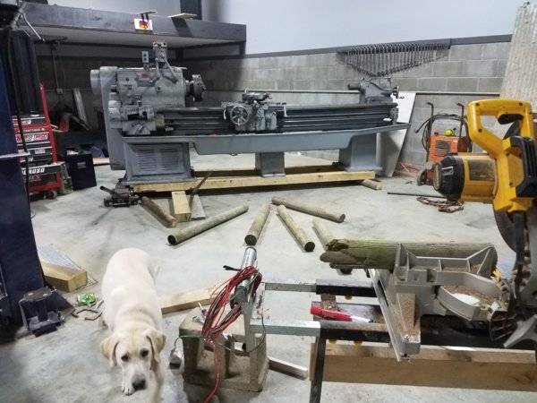

LeBlond very high quality. I have to ask you, how in the name of God did you move that by yourself. I figured you were a big boy when i seen those 10-12foot sheetrock boards you put up by yourself but a lathe that big LOLWell I'm finally getting back to the garage now that the renovation and the kids sports are done... problem now is it rains every chance I have to work on it.

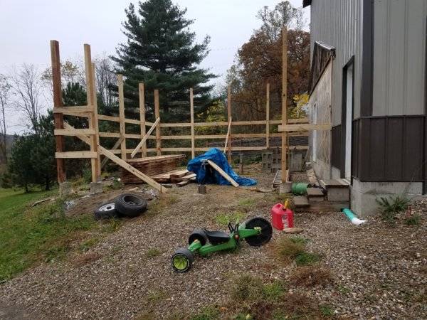

Today I anchored down all of the mounting brackets to the concrete piers and stood 2 poles. It was getting really late and the impact echoed all threw the valley, didn't want to tick off any neighbor's so I packed it in. Supposed to rain tomorrow but I'll do whatever I can with any decent weather that I get.
Incase anybody missed this in my other thread I brang home a new toy and had a blast moving it by myself. 13ft long LeBlond lathe.. big enough to put your rear end and then some in it.
Steve I think he has a 'Gator' type 4-whl stashed there also; so that begs the question of what the floor looks like from dragging that behemoth?LeBlond very high quality. I have to ask you, how in the name of God did you move that by yourself. I figured you were a big boy when i seen those 10-12foot sheetrock boards you put up by yourself but a lathe that big LOL
Having a dad who's dragged home machines all of his life you learn that anything can be moved with enough leverage and or rolls. When it showed up here my dad had already lagged it down to 3X6 white oak beams so I just jacked it up and slid 4" wooden rolls (fence post) under it. From there you just throw a soft board on the floor (poplar) to bite into with the spud bar and go to down. It also had to be spun around as well but it was all done with a bar, wooden rolls and a floor jack.LeBlond very high quality. I have to ask you, how in the name of God did you move that by yourself. I figured you were a big boy when i seen those 10-12foot sheetrock boards you put up by yourself but a lathe that big LOL

I have a 4wd Can Am and yes I tried it, it burnt the tires and didn't budge it an inch then I ripped the bumper off trying to tug on It! Wish I wouldn't have even fired it up.. something else to fix now!Steve I think he has a 'Gator' type 4-whl stashed there also; so that begs the question of what the floor looks like from dragging that behemoth?
