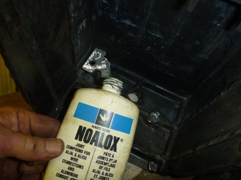

Also, if you slather it onto the back of an aluminum wheel, where it mates to the ferrous hub, it prevents the wheel from welding itself to the hub after a Canadian winter or two.

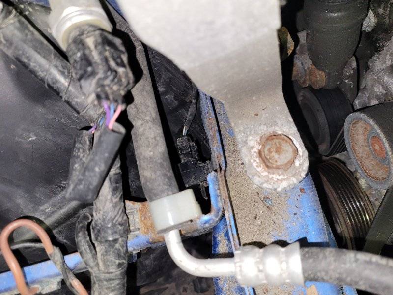

Actually, they are a "Hall effect" pickup. They create a frequency at specific amplitutde (voltage).On the ABS sensor testing... they are a simple ac voltage generator.. if you were Doc Browne from 1955 , you would hook up 4 ac voltmeters and drive/ watch for differences.
( or hope the new scanner will do it).
And as mentioned check resistance between sides.
If you can get at the connectors![]()

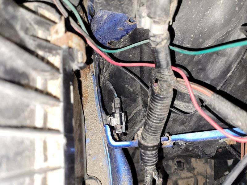

Already booked my flight to Japan so that I can kill some designer... here's the front connections where you can get one hand in to try and unclip them with zero extra length. Passenger side under the A/C lines...On the ABS sensor testing... they are a simple ac voltage generator.. if you were Doc Browne from 1955 , you would hook up 4 ac voltmeters and drive/ watch for differences.
Ah yes, could be. I was going by the tone ring vs encoder and the 2 wire connection.Actually, they are a "Hall effect" pickup. They create a frequency at specific amplitutde (voltage).
