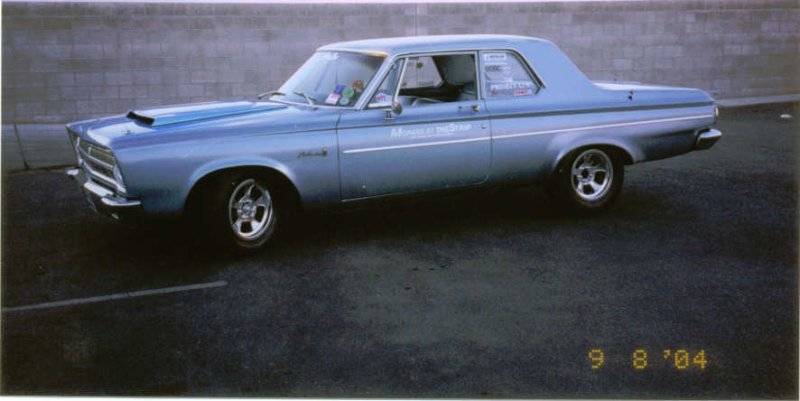

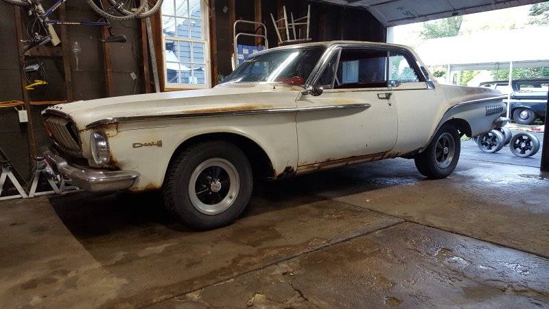

Just for reference my 65 had Super Stock springs in this photo.
Second photo is the stock springs.Pretty much the same.

Ahh thanks! And yeah, that first photo looks like stock springs, my SS springs were like i was going mud bogging:)

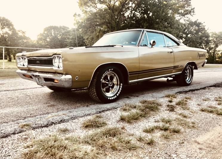

I don’t have an early b, but I do have espo +2” springs on my GTX. Great costumer service, and the quality is good!

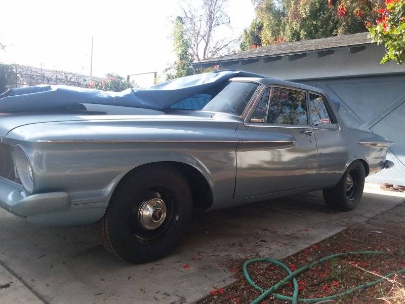

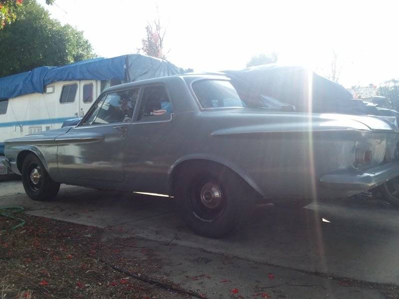

My 62, with 456/457 super stock springs, and a 1" rearward move.
