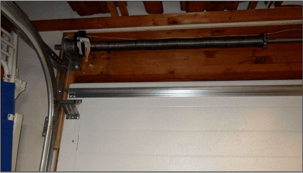

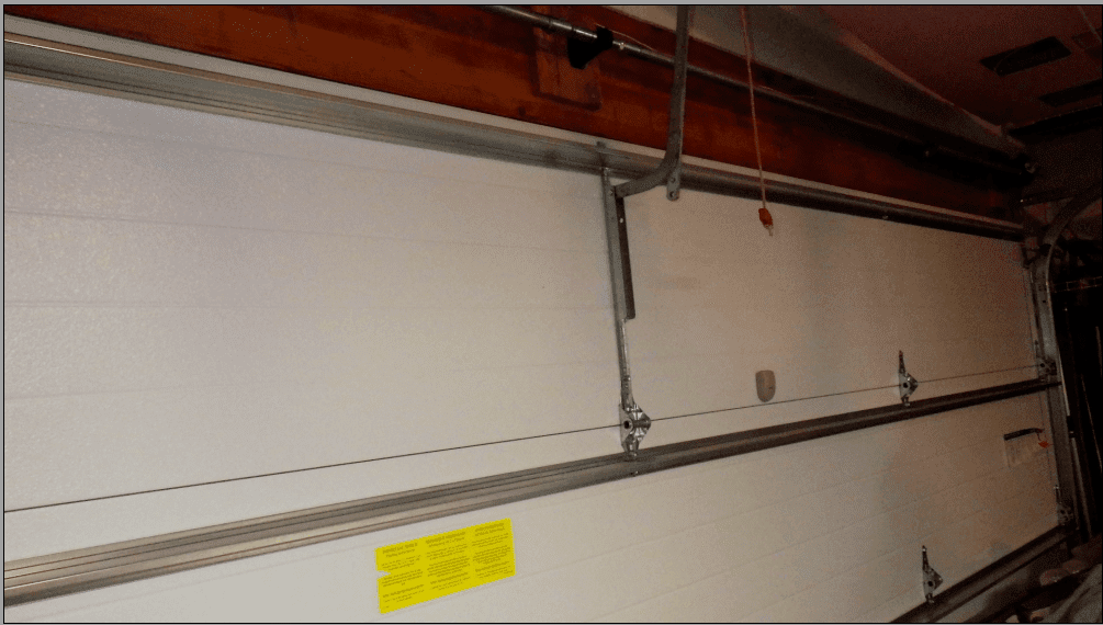

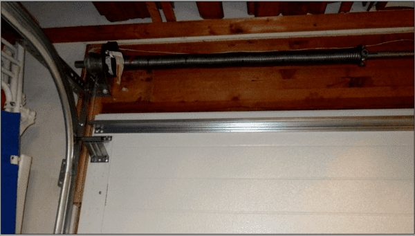

I had my door replaced with one similar to what Dave posted above;
The installer told me that when I redo my garage ceiling to call him and he would adjust it for me....basically ...don't mess with it, because it can be dangerous without the correct tools and knowledge. I follow instructions :D
It looked like a rat-trap when it was being installed.
