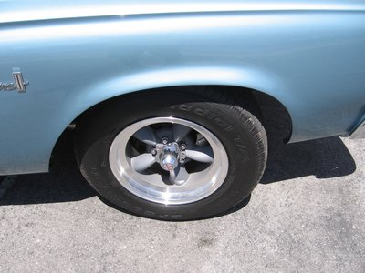

225/70/15 on 7"w 4 1/4" BS
These run real close to the front of the wheel well opening when the wheel is turned inward but should be ok. Passenger side is closer than driver side. I'll probably massage that a little so it doesn't grab when going through a dip.
Wheels turned straight
I had the same thing with a 64 Dart.But had it closer on the driver side.Had to trim the leading edge of the fender so I did them both to match.I guess when they say tolerances on Mopars are +or- 2'' they aren't joking. Well maybe a little.....
