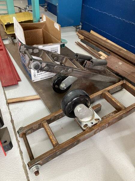

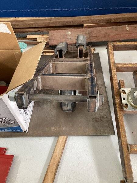

I'm not sure if this will be on Best Buy or Bend Pak or both. I was shopping for a 9k lb four post lift. Had been looking at Back Yard Buddy and the BP. The Buddy site showed them spinning a four post around with a Camaro on the ramps. I asked BB if the BP could do that also. They said yes, just not heavier than say 5k lb. Bought the BP from BB as the package deal with the rolling jack, delivery and setup was better than the BB. After it was put together I loaded my 65 onto it. Went to rotate it around on the supplied dollies and promptly folded two of them over. They are made of 1/4" x 1 1/2" strap. Dummy me, I didn't just get on the horn and go WTF. I just maneuvered the car, on the lift, around in the garage and just let it sit. Later on when I had to move it, I needed up making my own dolly frames out of some heavy wall rectangle tube, some solid for the hinge points. I re-used the casters that were supplied as the rolled better on the floor, they were hard plastic, than the urethane band ones I bought.

Now that my trailer is empty and could find the dollies I made for the lift, here are some shots of them. 1x2 090+ wall tube, solid material inside at the hinge points for the bolts. I also rosette welded them to the tubes so there is better strength in the assemblies. The only thing I re-used from the supplied BP units were the casters.
