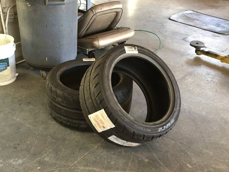

I have 200 TW tires on this car:
My first set of tires for this car "aged out" at 70 % tread up front and 50% tread out back. I had them right at ten years.
I replaced them in 2014 and am ready to replace them again this year but now they are worn out. The car has never handled better than it does now.
