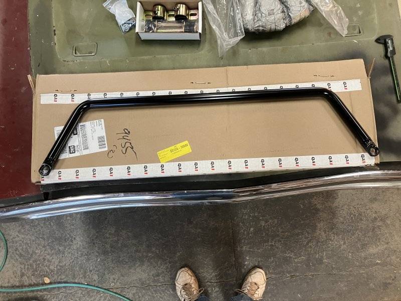

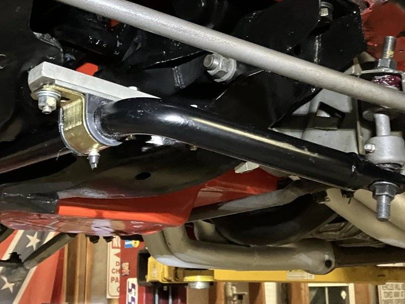

The rear bar works for my car too. I have a 3/4" bar from an '82 Imperial. It is like the Firm Feel design, frame mounted. I had a 7/8" Addco bar and with that, the car did have a slight OVERsteer tendency but that was due not only to the size but the short lever arms it had. The shorter the lever arms, the more effective the bar is because the car has less mechanical leverage against the center mass of the bar. Longer lever arms reduce the effectiveness of the bar. If you need an example, think of the difference between the front sway bars on a 66-69 B body and a 70-72. The early bar mounted outside the K member and had longer arms. The later version was mounted within the K member and had shorter arms but was a smaller diameter while maintaining a similar roll rate.
I drove my car with no rear bar and while it cornered fine, it had more body roll too. The 3/4" rear bar reduced the body roll but did not send the car into an oversteer condition at street speeds. I have not driven it on the track but I have pushed it on the street and it is as neutral as any car that I've driven. Dwayne drove the car but didn't push it anywhere near as hard as I do. It has no bad habits yet it has many components that SOME new members here advise against as being redundant or dead weight.
For example...Boxed lower control arms are like frame connectors where they reduce flex and let the torsion bars work without lost motion. With the LCAs, the reduced flex from having gusseted the underside allows the sway bar to not lose effectiveness to a twisted LCA.
The point is with leaf springs, especially with Mopar leaf springs with their short front segment the rear tends to stay fairly flat and a rear bar can induce oversteer... Another way of describing oversteer is it tends to make the car tail happy... Tail happy can be fun if your paying attention but it can bite you if your not.... Back when every car was set up to understeer like a pig and GM equipped Trans Am & Z28's with rear bars it was pretty common to see guys who thought they were the Bandit get the tail hung out & lose the car... But someone who knew how to use the cars could go pretty fast.....
That said if your running a big front bar on your Mopar a rear bar helps quite a bit.... I run a 1 1/4" front bar and an adjustable rear bar... I keep the adjustments to the lowest setting most of the time... I've pushed it to the highest setting to go out & play but honestly I don't drive that aggressively anymore so back to the low setting...

If your running a big front bar on your Mopar a rear bar helps quite a bit.... I run a 1 1/4" front bar and an adjustable rear bar... I keep the adjustments to the lowest setting most of the time... I've pushed it to the highest setting to go out & play but honestly I don't drive that aggressively anymore so back to the low setting...
I agree. I have a 1.25" hollow QA-1 front bar....
....and 1.15" torsion bars. The car understeers and has more body roll without a rear bar.
Except the LCA's are not flexing in the first place in ANY application by any readers here, and even if they did the flexing would be in series with the TB and only lower the spring a nearly infinitesimal unmeasurable amount, orders of magnitude less than the spring found in a typical 15" air inflated tire. Remember, the LCA it is not solidly mounted, it can only see forces the TB can supply by its chosen diameter, ie it only sees limited static forces in normal road use. If hitting curbs at high speeds and protecting your LCA is your number one priority, you should be adding 1/2" steel or larger gussets.
Offset SB forces from a 1"+ SB are much more likely to twist the LCA longitudinally on its pivot mounting, especially if OEM vs Delrin, and any of the beam bending that could arise is also nearly unmeasurable. This SB LCA gusset "twist benefit" was unveiled years after the original marketed benefit of stiffening the LCA began to become questioned.
I rate the above claim "pants on fire" and mostly a marketing claim for sales.
Nobody in nearly two decades has proven my above contention wrong.

All of this ^^ plus saying the LCA's don't deflect when using a larger than stock sway bar is silly. They were designed for a ~3/4" sway bar, using the typical 1 1/4" bar increases the force by several times (like ~8x)
Well if you are so certain and serious, tell us how much, what direction, and what negative outcome arises you claim from this 5'? long bent 1.25" bar deflecting this LCA that is of such concern?
Only three? possible answers I see, you don't know, you have actual measurements with and without a LCA lower welded gusset, or you are willing to admit you can only make a guess to this question based on blind faith?
