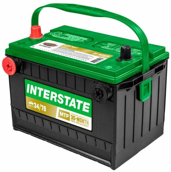

Anyone running with both top & side posts in their B-body? If so, which one? Any pics?
I'm looking for a good one for an under hood location in my 69 Coronet -preferably a lead acid style... but will consider AGM.
Reason: Soon I'll be installing EFI and the power connection needs to be directly on the battery and I don't want to splice into or crowd the OEM battery cable & post.
I'd prefer to use the extra side post for this. And a lead-acid battery for ease of long term preservation & maintenance.

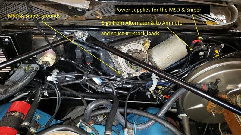

I ran my EFI off of the Starter Relay post, through the firewall onto a post under the dash.
Interstate Battery MTP 34/78 Dual terminal.
I also use a duel post battery for a sniper EFI in one of my cars. I’m using an AGM battery from NAPA.

Anyway, found one that will work.
The 34/78 series seems to be the key.
Local Advance Auto has this one for $149.99 incl. core
Model 34/78/4

Remove the DieHard paper labels, Paint the top letting black, Stick a Mopar label on the front and fake caps on top and....
I'll have a conversation piece!

My reasoning for a direct connection to the battery posts is primarily to minimize electrical turbulence or fluctuations that can potentially cause problems with these EFI systems.
Sure there are other ways to get your honey, but if you tap right into the hive you know it's pure :). However, I still want it to look good & stealthy.
No ammeter any more... I just monitor voltage.
