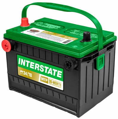

Anyone running with both top & side posts in their B-body? If so, which one? Any pics?
I'm looking for a good one for an under hood location in my 69 Coronet -preferably a lead acid style... but will consider AGM.
Reason: Soon I'll be installing EFI and the power connection needs to be directly on the battery and I don't want to splice into or crowd the OEM battery cable & post.
I'd prefer to use the extra side post for this. And a lead-acid battery for ease of long term preservation & maintenance.

Interstate Battery MTP 34/78 Dual terminal.
I also use a duel post battery for a sniper EFI in one of my cars. I’m using an AGM battery from NAPA.

Anyway, found one that will work.
The 34/78 series seems to be the key.
Local Advance Auto has this one for $149.99 incl. core
Model 34/78/4
