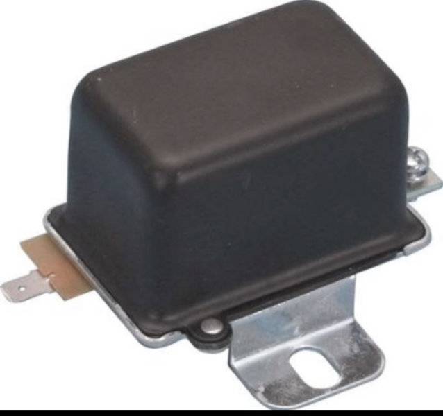

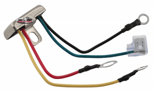

What is the alternator? Is it an aftermarket alternator, or an older Mopar single wire? Mopar alternators have internal rectifiers, but not regulators.
It’s a single wire tuff stuff I got within the last 5 yrs. I had used it on another project until I swapped it into the Charger.
They piggy back one of these on the alternator...

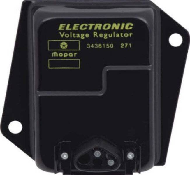

Think you are mistaken, Mopar uses a voltage regulator.
