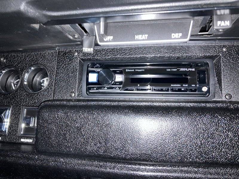

I did just about the same thing. I dremeled out a radio delete bezel and put in an Alpine. The original radio and bezel is safely stored in a box. Just love having USB, CD, Bluetooth, Sirius, Hand free phone, etc. Pioneer 6x9s in back under the package tray and two in the front with an adapter plate under the grill. The unit was about 175 or something from Crutchfield. My kid hooks up his phone via Bluetooth and plays songs from his phone as well (well beyond my needs but he loves doing that).

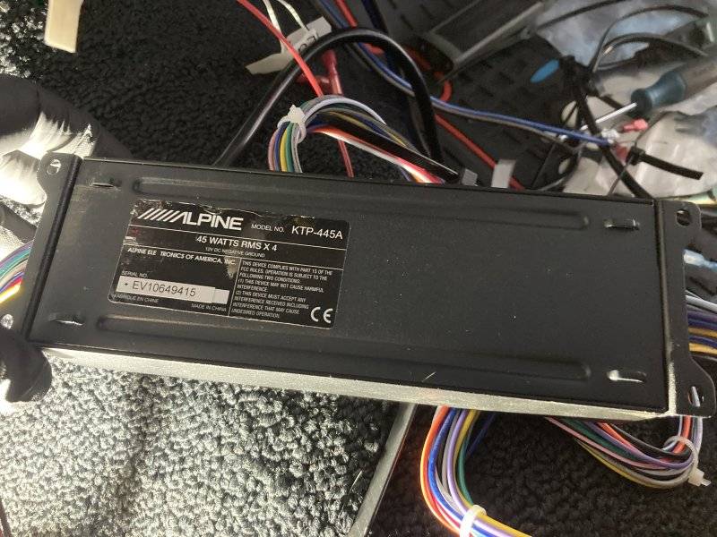

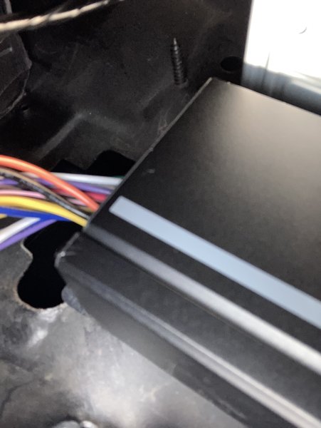

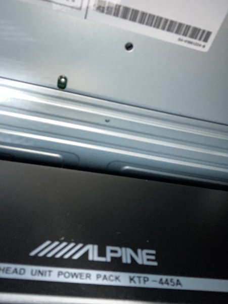

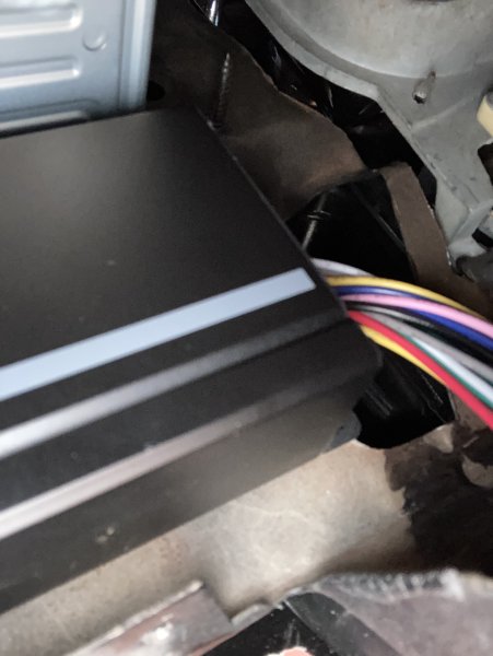

I know this is an older thread, but I posted my aftermarket alpine radio up in the posts a while ago. It's been great but sounds kind of tinny. After a lot of reading, and because we didn’t “really” need amps in the 70s/80s, I read that there is an alpine amp that just plugs in and boosts the sound. Wow, what a difference but where to mount? That is what I wanted to share. The mounting ears on the alpine amp are the exact length of the internal mounting holes for the dash. I just unscrewed that part of the dash screws, mounted the amp and done. Amazing and out of the way! It’s light enough that the two screws hold it very well and the other side rests on the dash frame. I know it works for my 70 but hey, who knows if someone will find this useful!
