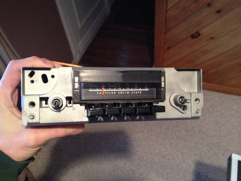

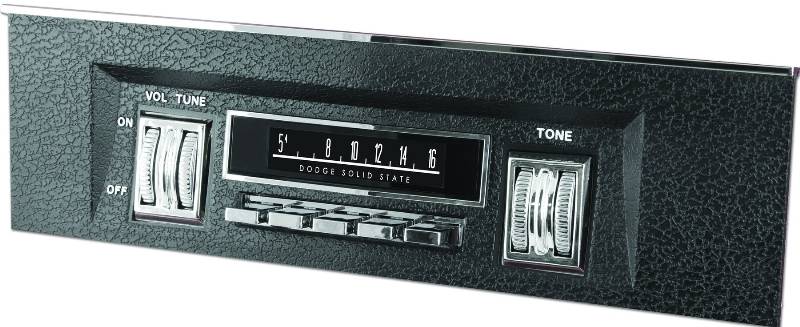

My thumb wheel radio for my 69 Bee is way beyond repair, functionally and likely cosmetically too. Pic is posted for illustration.
What is the best alternative for replacement? Have perused a couple sites that have aftermarket replacements but would like to hear suggestions and your experience. I need everything including antenna and speakers etc. TIA

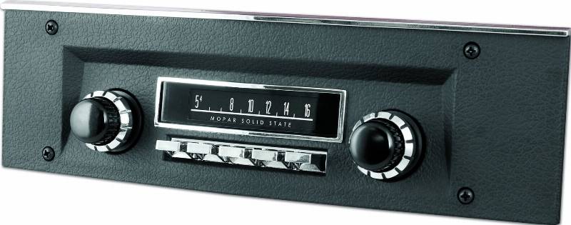

Retrosound makes a decent radio. Looks close to the original. Blue tooth/USB/Hands free Phone.. etc etc
Video I made.
I went the Retrosound route. Looks pretty similar to the original style. I wanted SiriusXM and Bluetooth, which is about all I use. I got the Retrosound 4x10 dash speaker and 2 Alpine rear speakers (6x9?) hung under the package shelf in the stock locations. Sound is OK at low speeds, but you have to crank it up at highway speeds. An amplifier, which I do not have, might help. Unit is smaller and much lighter than original radio and the original antenna wire came up short of the radio. Thumbwheels come separate from the main radio, and I had trouble getting everything to line up correctly on the dash, but it may be that I was just getting tired of lying up against the console trying to make everything look right.

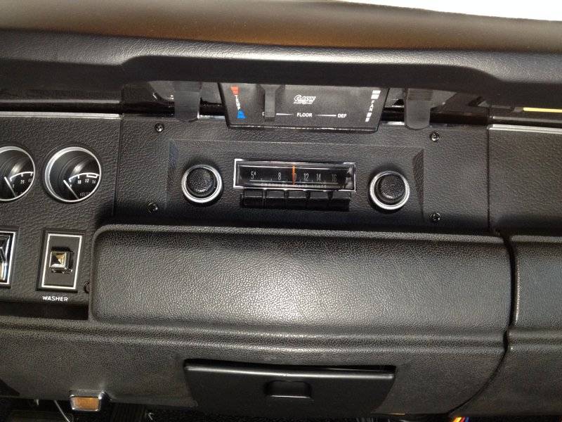

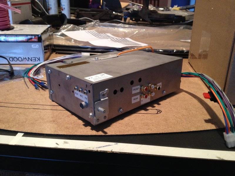

Here's my radio. It is a converted original so it obviously fits exactly as an original. Note the additional audio jacks added to it.
Here it is installed.

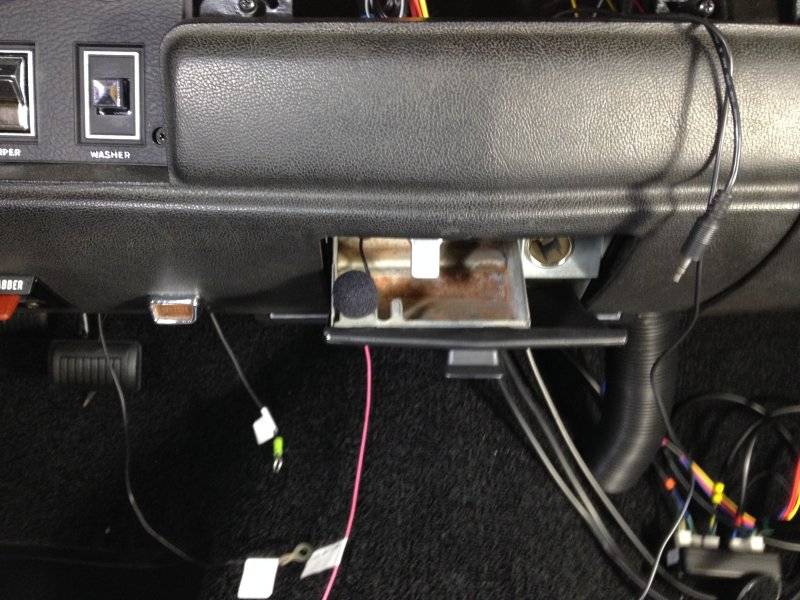

I hid the microphone in the ashtray for the hands free calling feature.

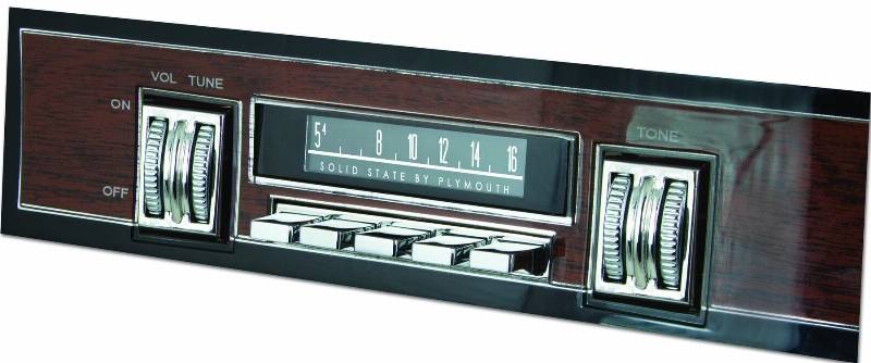

The retrosound radio has lenses that mimic the original lenses with Plymouth,Dodge and Chrysler script. So when the radio is off they look like a stock radio.
They are found on this page. Vintage Dial Screens

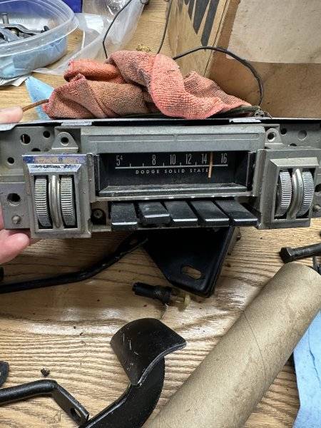

Dspur....I can help you with a conversion of a factory 69 thumbwheel radio. As mentioned above.....BT, FM stereo , aux jack can all be added to stock AM radio. Message me for more details. By the way....the radio in your first post above is a 68 B body radio. All 69 radios had Chrysler Solid State on the face. Joe
Thank you. I may need to source a 69 first. This was in a box when I bought the car. Funny I just discovered that my ignition switch is a 68 or earlier. I purchased new keys and a cylinder for it and when I got it would not fit After researching a bit I discovered that. I have a 69 on the way. This is an AC car and had a non ac middle dash pad on it, so I'm guessing somebody did some scavenging from a 68....
