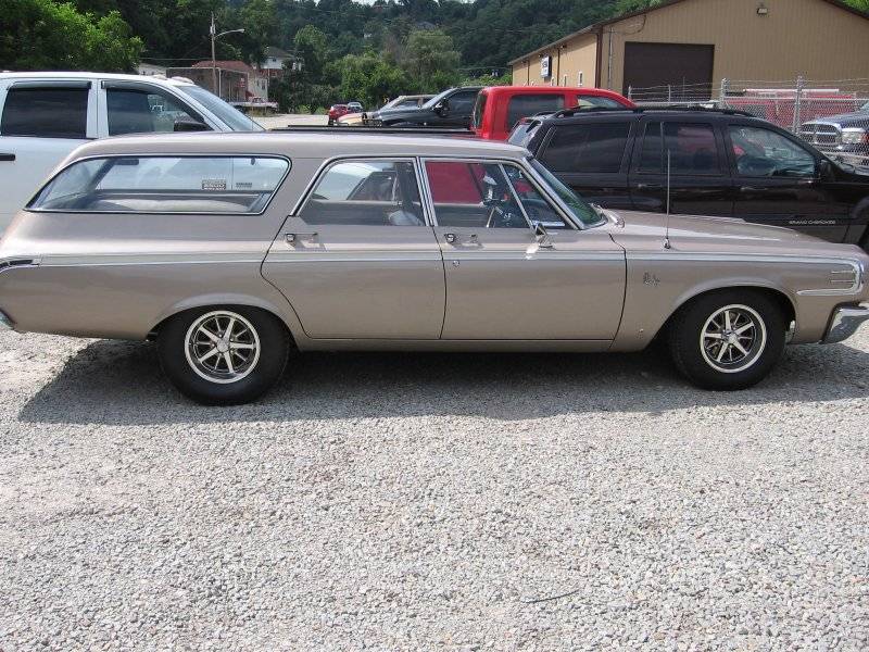

Did a 64 Plymouth station wagon with the Borgeson from Burgman.Box,pump and hoses.
Drives and handles very well. Rock Auto,is it a complete kit or just a box ?
Reason I ask is will Rock Auto provide you any support if needed ? Burgman will.

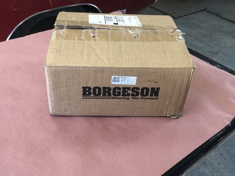

First, the name is Borgeson, not BorgeNson.
Secondly, the Lares steering box used to be a USED, rebuilt unit. I've read that they have actually tooled up to build their own NEW version of the Mopar factory unit.
If they did and IF their unit eliminated the on center slop that almost every Mopar power steering box had, it might be worth a try. The ratio of the Borgeson is better at 14 to 1 compared to the 15.7 to 1 factory unit.
I've driven cars with the OEM Mopar steering box, Firm Feel Stage 2 and 3 and now the Borgeson. A good factory unit that has no slop is a decent choice. If there is any slop at all, it will only get worse. The Borgeson is a modern design and isn't as likely to develop that slop.
The Borgeson is expensive though.
